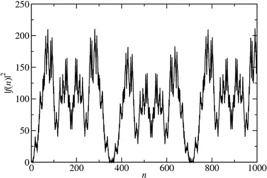

So... I checked my idea numerically, and the results are very weird. Take a look:
$f(n)$ for $n\leq 1000$ $f(n)$ for $n\leq 10^{10}$
The orders of magnitude are about right, which supports my heuristic argument. However, the function is not at all well behaved. The expected relative fluctuations in $|f(n)|^2$ if it's an $n$-step random walk are $1/\sqrt{n}$; the fluctuations we're seeing here are way larger than this. Also, there is obviously some periodicity to $|f(n)|^2$, with periods at least as long as $10^9$. I even suspect there's some self-similarity in $|f(n)|^2$: the entire curve in the second plot isn't so different from the individual little 'teeth', and the function has significant structure both on the scale of $n\sim 10^3$ and $n\sim 10^{10}$.
Personally I highly doubt this function is $o(n^\epsilon)$ $\forall \epsilon>0$, but otherwise I don't know what it is.
