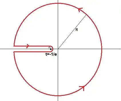

The proof uses the fact that the function $W(z)/z$ is holomorphic on the domain $D=\mathbb{C}\setminus (-\infty, -1/e]$. By Cauchy's integral formula, it follows that: $$\frac{W(z)}{z}=\frac{1}{2\pi i}\int_C \frac{W(t)}{t(t-z)}~dt$$ where $C$ is a positively oriented keyhole contour, as follows:
Letting $r\to 0$ and $R\to \infty$, it can be shown that this reduces to (it can be shown that the contributions of each circle to the integral is zero): $$\frac{W(z)}{z}=\frac{1}{2\pi i} \left[\int_{-\infty}^{-1/e} \frac{W(t)}{t(t-z)}~dt+\int_{-1/e}^{-\infty} \frac{\overline{W(t)}}{t(t-z)}~dt\right]$$ Note that in the above we have used that for $x\in D$, we have that $W(\overline{x})=\overline{W(x)}$. Additionally, we have that for all $w\in \mathbb{C}$ that $\Im(w)=\frac{w-\overline{w}}{2i}$, hence the integral reduces to: $$\frac{W(z)}{z}=\frac{1}{\pi} \int_{-\infty}^{-1/e} \frac{\Im(W(t))}{t(t-z)}~dt=\frac{1}{\pi} \int_{-1/e}^{-\infty} \frac{\Im(W(t))}{t(z-t)}~dt$$ The article then proceeds to use the change of variable $\nu=\Im(W(t))$. The variables can be shown to be related by: $$t=-\nu \csc(\nu) e^{-\nu \cot(\nu)}$$ Differentiating gives: $$dt=-\csc(\nu)e^{-\nu \cot(\nu)}(\nu^2+(1-\nu\cot(\nu))^2)~d\nu$$ Hence, it follows that (since $t=-1/e$ gets mapped to $\nu=0$ and $t\to -\infty$ gets mapped to $\nu=\pi$): $$\frac{W(z)}{z}=\frac{1}{\pi} \int_0^{\pi} \frac{\nu^2+(1-\nu\cot(\nu))^2}{z+\nu \csc(\nu) e^{-\nu \cot(\nu)}}~d\nu$$ Since the integrand is even with respect to $\nu$, we obtain the desired result.
