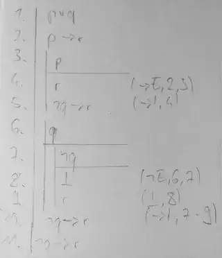

A proof of $p \lor q, p \to r \vdash \neg q \to r$ looks something like this:
(natural deduction, Fitch (= linear) style)

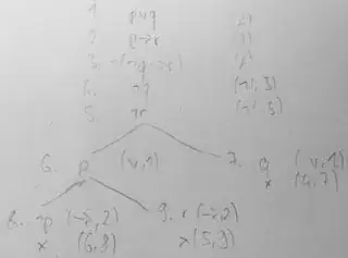

or this:
(tableau/truth tree)
