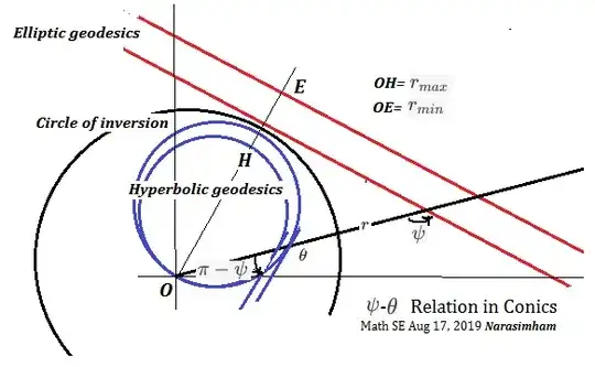

Angle $\psi $ is reckoned counterclockwise direction consistently from radius vector to one of parallel geodesics. Constant rotation $\phi$ and curvature in two dimensions shown here:
Elliptic geometry
$$ \phi_{Elliptic}= \psi +\theta = const $$ Differentiating with respect to arc for elliptic straight lines $$ \psi^{'}+\frac{d\theta}{ds} = \psi^{'}+\frac{\sin \psi}{r} =\kappa_{gElliptic}=0$$ Re-integrate we get Clairaut's constant in polar coordinates: $$ r\cdot \sin \psi = r_{min} = OE $$
By Inversion
the angle $\psi$ remains constant in magnitude but changes sense/relative direction into
Hyperbolic geometry
$$ \phi_{Hyperbolic}= (\pi-\psi ) +\theta = const $$ Differentiating with respect to arc for hyperbolic straight lines
$$ \psi^{'}-\frac{d\theta}{ds} =\psi^{'}-\frac{\sin \psi}{r} =\kappa_{gHyperbolic} =0$$
Re-integrate we get constant ; $$ r/\sin \psi = r_{max} = OH $$

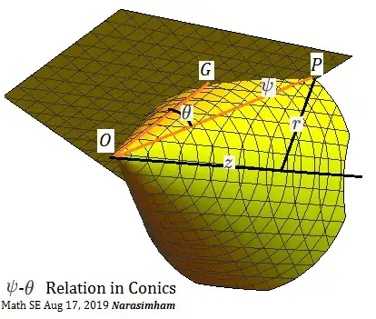

$ (r, \theta, z) $ are cylindrical coordinates and tangent at $P$ to conic makes angle $\psi $ to cone generator $OP$ to compare in this form their projections with elliptic and hyperbolic geodesics in two dimensions. //
If it is constant for example when $ \psi = \pi/2 \text{ at } G $ then we have a circle formed by cutting a cone of any semi-vertical angle with a plane perpendicular to the cone axis.

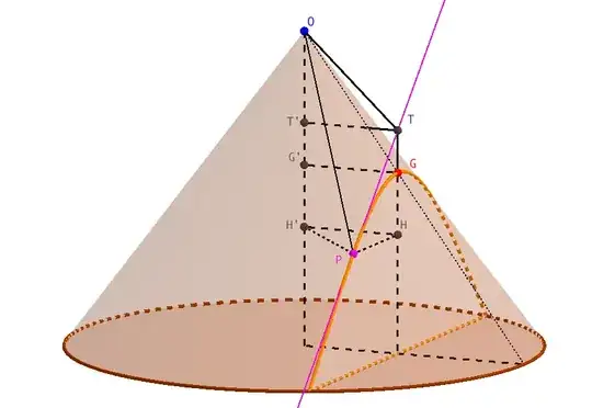

Let $G'$ be the projection of $G$ (vertex of the hyperbola) on the axis of the cone, $H$ the projection of $P$ on the axis of the hyperbola and $H'$ be the projection of $H$ on the axis of the cone. If we set: $$ x=OH',\quad y=PH,\quad a=OG',\quad b=GG'=HH', $$ it is easy to show that the usual equation holds: $$ \tag{1} {x^2\over a^2}-{y^2\over b^2}=1. $$ If $T$ is the intersection of the tangent at $P$ with the axis $GH$ of the hyperbola, and $T'$ is the projection of $t$ on the axis of the cone, then we find $$ OT'={a^2\over x}. $$ The lengths of $PT$, $PO$ and $OT$ can be now found as a function of $a$, $b$, $x$, $y$, and $\psi=\angle OPT$ can be computed by the cosine rule as: $$ \tag{2} \cos\psi={\displaystyle\left(1+{b^2\over a^2}\right)x^2-b^2-a^2\over \displaystyle x\sqrt{1+{b^2\over a^2}} \sqrt{\left(1+{b^2\over a^2}\right)x^2 +{a^4\over x^2}-2a^2-b^2} }. $$ If $\theta=\angle PH'H$ is the usual azimuthal angle, then $$ \tag{3} \tan\theta={y\over b} \quad\text{and}\quad x^2=\left(1+{y^2\over b^2}\right)a^2={a^2\over\cos^2\theta}. $$ Substituting that into $(2)$ finally gives: $$ \cos\psi={\sqrt{a^2+b^2}\sin\theta\over\sqrt{a^2\sin^2\theta+b^2}}. $$
