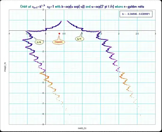

Now towards my question: The picture using that $c= \small "golden-ratio"$ shows a pattern which suggests two parallel orientations in that orbit, which I didn't observe in the other above classes. Usually the orbits for the irrational bases look more like some closed star-form shape with fractional borders and excurses "towards infinity", but here I find a somehow "most simple" shape.
It is much time-consuming to compute the orbit to millions or billions iterations, but I did a fairly usable list of that iterations ($1e8$). The indication of that parallel orientations becomes even stronger with longer orbit.
a) Can we prove, that the continuation of the orbit fills out the pattern so far, such that we have that two partial orbits along two parallel directions?
b) What might be the reason for this remarkable shape?

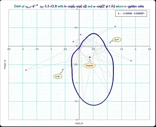

Update: It might be interesting (and possibly helpful to avoid misleading ideas) to see, that selecting a different startvalue $z_0$ can lead to an asymptotically closed(?) (and dense?) curve. I used $z_0=1.1+0.1I$ finding that initial orbit for the first $2000$ iterations:
To see the initial behave the first $20$ or so iterates are connected by the thin grey line and have an additional frame around the dots.

  • I generated the formal series for the inverse Schroder function for your base and I'm trying to match your third plot with $z_0=1.1+0.1i$, but I think maybe you actually used $z_0=1.0-0.1i$ for your third plot? My plot for the formal analytic inverse schroder function is very close to your 3rd plot using $z_0=1.0-0.1i$. – Sheldon L Aug 16 '19 at 08:43
  • The exactness of the $z_0$ initial value seems not to be essential. I just looked for instance for starting values nearer to the real line, just by taking mean value of two near iterates as new $z_0$ - it was surprisingly robust: all tried $z_0$ ran into one stable "closed curve" of roughly egg shape; for instance I took $z_0 = 0.926966+0.0 î$ which is nearly on the egg-shape interpolated (or asymptotically dense?) curve. If something still is unsatisfactory, please write again here. – Gottfried Helms Aug 16 '19 at 09:43
  • @SheldonL - ah, I think I got it. I guess your value $z_0=1.0-0.1î$ seems to be one dot already *on* the curve in my third plot. My own initial $z_0=1.1+0.1î$ is off the curve but iterations from there converge to that curve nonetheless. So maybe the Schroeder-function does not work well with points off the curve. (remark: I've earlier introduced the term "equator" for that non-contracting, non-diverging orbits which seem to form dense curves when iterations go to infinite height. Perhaps that term "equator" is a good choice and could be used for that phenomenon) – Gottfried Helms Aug 16 '19 at 09:49
  • @SheldonL - I've reproduced the Schröder-function approach and indeed $z_0=1.1+0.1î$ is not a good parameter for the function. But iterating it $11$ or $18$ times makes it a nicer argument for the Schröder-powerseries... – Gottfried Helms Aug 16 '19 at 10:08

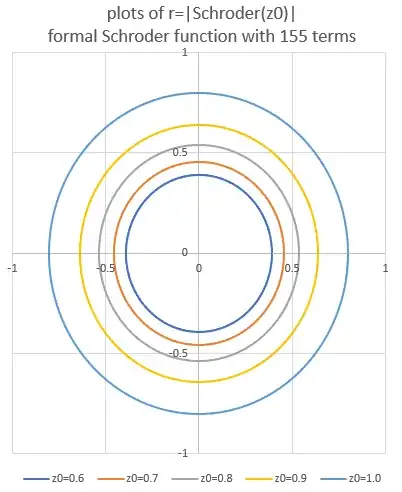

The Op's base is base b. $$\phi=\frac{\sqrt{5}+1}{2};\;\;\;\;\lambda=\exp\left(\frac{2\pi i}{\phi}\right)\;\;\;$$ $$b=\exp\left(\lambda\exp(-\lambda)\right);\;\;\;l=\exp(\lambda);\;\;\;l=b^L$$ The derivative at the fixed point is $\lambda$ since $\exp_b(l+x)=l+\lambda x + O(x^2)$. I generated the formal Schroder function $\Psi$ at the fixed point of l such that: $$\Psi(b^z)=\lambda\Psi(z)$$

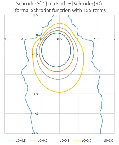

Then I generated $\Psi(0.6,0.7,0.8,0.9,1.0)$ which matches the Op's previous plots at 0.7 and 0.8. I actually used $\Psi^{-1}$ and Newton's method for the inversion. For the plots below, a 155 term Schroder function Taylor series for $\Psi^{-1}$ is accurate to
  • 38 decimal digits for $|\Psi(0.6)|$
  • 30 digits for $|\Psi(0.8)|$; 18 digits for $|\Psi(0.9)|$
  • 1.5 to 3 digits for $|\Psi(1.0)|$
You get the analytic limit for the fractal by starting with the singularity at $\Psi(0)$ or $\Psi(1)$ so the Schroeder function isn't that accurate, but it made a cool plot and I was surprised how well the $\Psi^{-1}$ Taylor series modeled the fractal boundary for $\Psi(1)$. For the other cases $\Psi(z_0)$ initial values, $\Psi^{-1}$ works extremely well. Gottfried's iterated sequences are equivalent to formally iterating:
$$z_n=\exp_b(z_{n-1});\;\;\;z_n=\exp_b^{[\circ n]}(z_0);\;\;\;\Psi(z_n)=\lambda^n\Psi(z_0)$$ $$z_n = \Psi^{-1}(\lambda^n\Psi(z_0));\;\;\;$$
Since the limit of the set of points mapped by iterating $z\mapsto \lambda z$ is the unit circle, then the limit of the iterating sequence is formally equivalent to plotting the points mapped from a circle that has a radius of the absolute value of $|\Psi(z_0)|$ $$\Psi^{-1}(|\Psi(z_0)|)$$ enter image description here

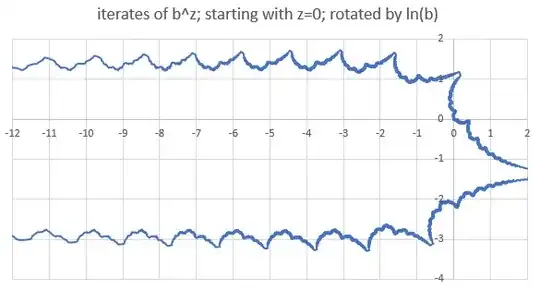

Here is one more picture, showing the iterates of $z \mapsto b^z$ starting with $z_0=0$; and then multiplying each point $z \cdot \log(b)$, so that the logarithmic singularity goes to negative infinity for $\log(z)$ where z is in the neighborhood of zero; as expected. Here the vetical part of the logarithmic singularity covers a little more the $\pi i$ which also makes sense. enter image description here

  • Hi Sheldon, this is again a treasure of thoughts and comments leading forward. Thanks very much! I'll need a bit to metabolize all. Just a small comment. For the initial value $z_0=1.0$ it would be better the curve were not connected. It seems it is infinitely often open at the curvy excesses in your picture. I looked at the area of the $h=514233$'th iterate which is about $-0.674467 - 0.881450$ and with its neighbours of further and backwards iterates in steps taken from the cf-convergents (for instance $h+=121393$ or $h+=514229$ or so) it looks still spiky with an always open gap outwards. – Gottfried Helms Aug 17 '19 at 03:15
    @gottfried agreed; its an open curve with open gaps. My graph starting with $z_0=1$ was over the Schroder function approximation with 155 Taylor series terms, not of the iterates themselves, so it is a continuous, but only an "approximation". – Sheldon L Aug 17 '19 at 03:19
  • Perhaps mention explicitely in the post? – Gottfried Helms Aug 17 '19 at 03:22
  • "singularity at .. $\Psi(1)$ so the Schroeder function isn't that accurate, but it made a cool plot ..." I was actually surprised by how well the Schroeder function Taylor series modeled the fractal singularity. – Sheldon L Aug 17 '19 at 03:24

  • I have one more plot I didn't post of the iterates of $z \mapsto b^z$ and then plotting $z\dot\ln(b)$. There the logarithmic singularity very clearly goes to negative infinity as expected for log(z) near z=0., It looks like a little more than $\pi i$ in the vertical direction plus lots of other copies the singularity along the branch to minus infinity. Adding the picture now ... – Sheldon L Aug 17 '19 at 03:38
  • Yes, that rotation-plot looks very good. I'll try to reproduce your ideas from the start again, but need sleep now. I'll try also the Newton-algo for to compute the $\Psi()$ from the $\Psi^{-1}()$ (I've always enhanced the range of convergence of the $\Psi()$ using Euler-summation on the non-converging series (but which has its limits, seemingly especially in this case). I'll return to this tomorrow. Thanks so far! – Gottfried Helms Aug 17 '19 at 03:50

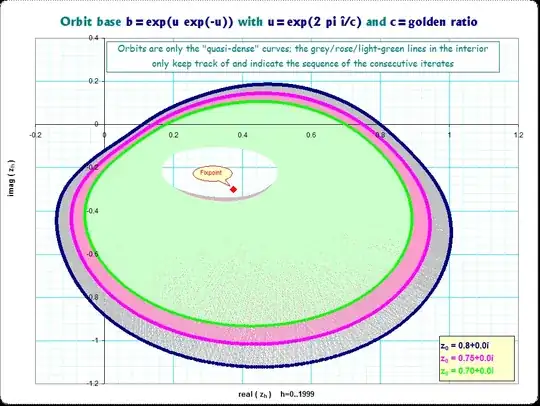

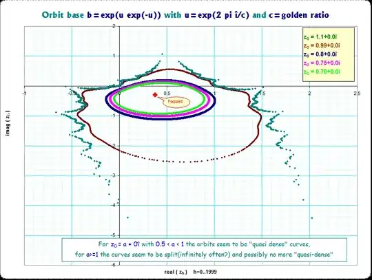

this is not an answer but only an extended comment detailing one aspect of the effect shown in the third picture
For the subject of initial values $z_0$ thrown in the comments of @SheldonL I show a composite picture made from three $z_0$ on the real line between $0$ and $1$.
Surprisingly each of three rather randomly chosen initial values produced its own shape ("equator") which does not change its visual image when iterated further but only fills the circumference of the shape/"quasi-dense curve" more densely.
It's worth to remark that when $z_0$ taken from some random value, say $z_0=1.5+1.3 î$ then this orbits even into a finite period of $3$ accumulation/periodic points - so that observation of "quasi-dense equators" (so-to-say) is not a general effect of this type of infinite iteration. The following picture shows the image for $z_0=1.1$ to give a bit more context:
