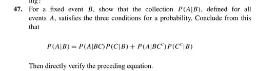

I am trying to solve the following question from Sheldon Ross, Introduction to Probability Models.
chapter 1 question 47 sheldon ross

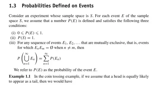

I am struggling to prove the first of the 3 conditions,
the 3 conditions for a probability
