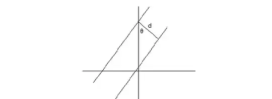

It is easier to figure out the distance from the right triangle formed by one of the lines, the vertical axis and the distance-line itself, as shown in the graph.
The intersections of the vertical axis with the two lines are $-c_1/w_2$ and $-c_2/w_2$, respectively. And the tangent of the two line is $\tan\theta=-w_1/w_2$. According to the right triangle in the graph. the distance $d$ is simply,
$$d=|c_1/w_2-c_2/w_2|\cos\theta=\frac{|(c_1-c_2)/w_2|}{\sqrt{1+w_1^2/w_2^2}}=\frac{|c_1-c_2|}{\sqrt{w_1^2+w_2^2}}$$
where $\cos\theta=1/\sqrt{1+\tan^2\theta}$ is used.
