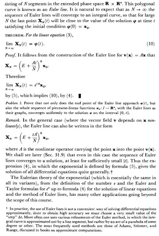

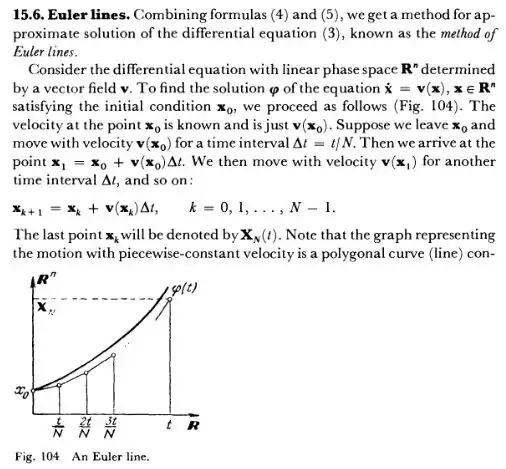

The ubiquity of $e$ stems from the ubiquity of $e^x$. And $e^x$ is ubiquitous due to the fact that it permits one to solve any higher-order LDE with constant coefficients - either by factoring its differential operator over $\mathbb C$ into linear factors, or by converting it into linear system form and using matrix exponentials. See the exposition by Arnold below, from his beautiful textbook "Ordinary differential equations". As Arnold says "the exponential ... gives the solution of all differential equations quite generally"
alt text alt text
