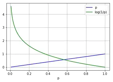

Now, before moving to more complicated cases, let's look at a plot of the factors involved in the entropy formula. Let me rewrite the formula first as follows:
$$ - \sum_{i} p_{i} \log(p_{i}) = \sum_{i} p_{i} \log \left(\frac{1}{p_{i}} \right)$$
entropy0
Looking at this plot you see that there is nothing really special about $\log \left( \frac{1}{p} \right)$, really any function of $p$ such that $f(1) = 0$ would have done the trick.

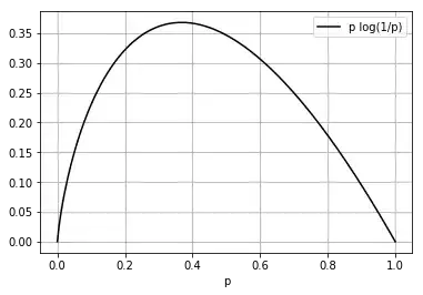

Now, you might wonder, what if I have two possible outcomes, one that is nearly certain and one that is very unlikely; for example $p_{1} = 0.999$ and $p_{2} = 0.001$. This case is tricky!
For the first outcome, we see that $p_{1} \log\left(\frac{1}{p_{1}} \right)$ is a number very close to zero. That first outcome is not too different from the single-outcome situation we looked at before.
For the second outcome, $p_{2} = 0.001$, let's think about the limit of the product $p\log(\frac{1}{p})$ as $p \rightarrow 0$. Intuitively, we know that if we add an extremely unlikely event, such as the one with $p_{2} = 0.001$, the "randomness" situation should not really be that different from our original single-outcome process.
Let's look at a graph to see what the definition of entropy does for us in this case:
Beautiful! This means that an extremely unlikely event contributes nearly zero to the entropy of the system. Extremely likely and extremely unlikely are similar in terms of their "randomness": they have pretty much none of it!

  1. An extremely likely event should not contribute much to the randomness measure.
  2. An extremely unlikely event should not contribute much to the randomness measure.
  3. Randomness should be additive.
Pedro M Duarte

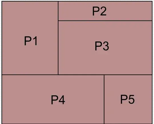

Information as reduction of uncertainty
An intuitive idea for understanding the information given by the unveiling of a random variable is to see this unveiling as a reduction of the space of what was possible before the variable was unveiled.
Suppose that you have a mysterious point $U$ that can be anywhere in a volume $V$ with uniform probability. A random variable X can be seen as a partition of $V$ into $N$ different smaller volumes $p_iV$. Due to uniformity, $U$ has the probability $p_i$ to be in the volume $V_i$.
Where is U?
Unveiling X will let us know in which domain $U$ stands. So, the possible area for $U$ will be reduced. The value of the new volume will be $p_iV$. We can define the reduction $r$ by $p_i$ itself. It can be seen as a function of $X$ and so, also as a random variable (that is why I prefer to call it r instead of $p_i$ that would be confusing). When $X$ has been unveiled, the intuitive notion of received information can safely be linked to the reduction $r$ (the smaller $r$, the more information I have received). Anyway, introducing a measure of information (like $\log(p_i)$) although tempting, is not useful right now. It will give some magic to the concept that will leads us too easily to the Shannon entropy that we want to discover without magic...
Shannon entropy as a metric to summarize reduction of uncertainty associated with a random variable
Now, suppose that $X$ has not yet been unveiled. We might find it useful to summarize the ability $X$ has to reduce $V$, through a single number.
Of course, a good candidate is the Shannon entropy, the opposite of the expected log of the reduction $r$ : $H=-\sum_ip_i\log(p_i)$.

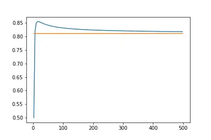

Let me try to answer to part of your question where you ask how it's related to the "physical world" taking the same direction as MichaelNgelo's answer.
Let's say you have $N$ objects, out of them there are $n_1$ many $A$s and $n_2$ many $B$s.
How many ways can you order them? For example for $N = 4$, with one $A$ and three $B$s we have: $$ABBB$$ $$BABB$$ $$BBAB$$ $$BBBA$$
This is a combinatorics problem and we can find the formula: $$\frac{N!}{n_1!n_2!}$$
Note that there are more cases with $N=4$ and a arbitrarly number of $A$s and $B$s ($16$ cases) or with $N=4$ and with two $A$s and two $B$s ($6$ cases).
Given the proportions of $A$s and $B$s, it reduces the number of possibilities and we just need a way to differentiate between them.
This is where the logarithm comes in to tell the least amount of bits to differentiate between these $M$ cases. Explicitly we need $\log_2(M)$ bits.
Now divide by $N$ to find the number of bits needed per symbol in the sequence. So if put all together, the formula becomes:
$$\frac{\log_2(\frac{N!}{n_1!n_2!})}{N}$$
and for convenience instead of talking about $n_1$ and $n_2$ in absolute number, we talk about the fraction of $N$, respectively $f_1$ and $f_2$. Finally tending $N$ to infinity gives the shannon entropy.
Example with $f_1 = 0.25$ and $f_2 = 0.75$:
Graph of increasing N approaching shannon entropy
Someone experienced can probably derive the Shannon entropy formula from the formula above with $N$ tending to infinity.
So a possible interpretation of the Shannon formula would be: The number of bits needed per symbol given the proportions of each symbol in advance in an infinite sequence.
