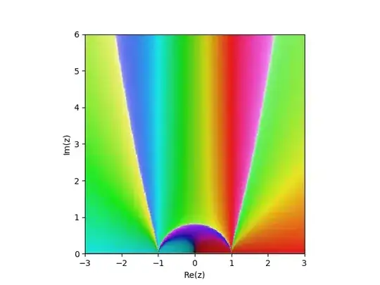

For algebraic centres, which make up the vast majority of centres in the ETC, the associated infinity curves are also algebraic, and the problem then is to find an exact bivariate polynomial describing them. They can be derived by setting the sum of barycentric coordinates equal to zero, then expanding, simplifying and factoring. For example, the Exeter point $X_{22}$ has triangle centre function $a(b^4+c^4-a^4)$, from which I derived $$\infty_{22}(x,y):3x^4 + 2x^2y^2 - 6x^2 - y^4 - 6y^2 + 3=0$$ Infinity curves can be visualised (or determined not to exist) for a given centre by making a complex plot of the centre's location for the triangles $(-1,0),(1,0),(x,y)$ with varying $z=x+yi$. Here is such a plot for $X_{22}$; the infinity curve is white and marks discontinuities in the hue.

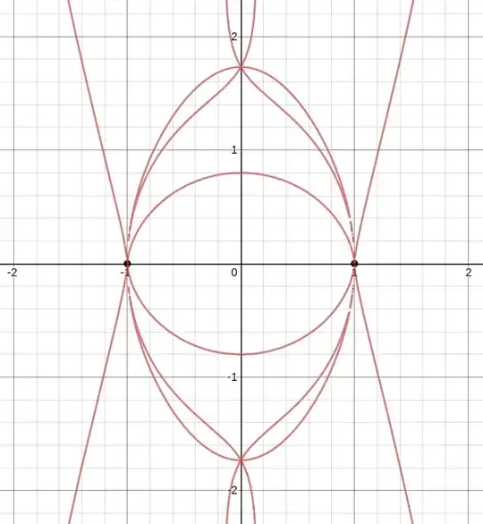

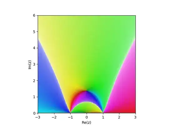

Take for example $X_{29}$ with centre function $\frac{\sec A}{\cos B+\cos C}$. Its complex plot looks like this, the infinity curve being a simple W-shape on the upper half-plane: The polynomial I have computed as $\infty_{29}$, on the other hand, produces that and more: $$27 x^{16} + 144 x^{14} y^{2} - 216 x^{14} + 306 x^{12} y^{4} - 864 x^{12} y^{2} + 756 x^{12} + 324 x^{10} y^{6} - 1404 x^{10} y^{4} + 2160 x^{10} y^{2} - 1512 x^{10} + 171 x^{8} y^{8} - 1180 x^{8} y^{6} + 2430 x^{8} y^{4} - 2880 x^{8} y^{2} + 1890 x^{8} + 36 x^{6} y^{10} - 540 x^{6} y^{8} + 1480 x^{6} y^{6} - 1800 x^{6} y^{4} + 2160 x^{6} y^{2} - 1512 x^{6} - 132 x^{4} y^{10} + 530 x^{4} y^{8} - 600 x^{4} y^{6} + 270 x^{4} y^{4} - 864 x^{4} y^{2} + 756 x^{4} - 16 x^{2} y^{12} + 92 x^{2} y^{10} - 124 x^{2} y^{8} - 140 x^{2} y^{6} + 324 x^{2} y^{4} + 144 x^{2} y^{2} - 216 x^{2} + 4 y^{10} - 37 y^{8} + 116 y^{6} - 126 y^{4} + 27=0$$
This curve appears to be decomposable into four parts, one of which is the one I want. The problem is that the polynomial is absolutely irreducible, something I have checked with my implementation of Gao's factorisation algorithm (one of whose steps I inquired about in this question). I want to eliminate the unwanted branches of this curve, but factoring does not seem to be the way.
Given an irreducible algebraic curve with several distinct branches like $\infty_{29}$ above, how can I select a specific branch and remove the others?

  • If you have checked rigorously that the polynomial is absolutely irreducible, then any branches the curve might have exist only over the reals, i.e., it's all one and the same curve, just hiding underground like a mountain river to later resurface again. I guess there are algorithms for isolating these real branches (Basu, Pollack and Roy seems to be the canonical reference), but this isn't the sort of thing that makes a lot of sense to do in triangle geometry (which is generally base-field-agnostic). – darij grinberg Apr 29 '21 at 10:54
