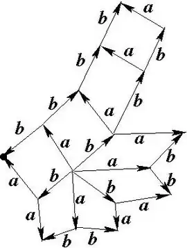

Let $G=\langle X; \mathbf{r}\rangle$ be a group given in terms of generators and relators. It is often useful to see what a word representing the identity element of the group will look like.
Write every relator on a circle. These are our tiles.
Let $W$ be a word over $X$ and write $W$ in around a circle. Then $W$ is equal to the trivial word if and only if $W$ can be "tiled" by the relators (this make sense as cyclic shifts (and, indeed, all conjugates) of $W$ are also equal to the identity).
This is a very powerful tool, and a snazzy way of visualising your groups. These are called van Kampen Diagrams, or just Diagrams. There is also a dual notion, called Pictures.
An excellent reference to this is the end of the book "Combinatorial group theory" by Lyndon and Schupp (the chapter on small cancellation theory). Another excellent, but more modern, reference is the lecture notes of Hamish Short, Diagrams and groups (but I am less familiar with these).
For example, look at the group presentation $\langle a, b; [a, b]\rangle$. Then a valid diagram is (from Wikipedia),
A sample diagram
Fixing a vertex on the boundary and reading clockwise around the boundary then the word you get is necessarily equal in the group to the trivial word.
Now, if these tiles have a certain structure (e.g. a small cancellation structure) then you get a solution to the word problem and the conjugacy problem (and sometimes even the isomorphism problem, but that is a very recent result and boils down to hyperbolic groups). For example, if there is no way of fitting less than four tiles around a given tile (this is called the $C(4)$ condition), and when tiling every (internal) vertex is adjacent to at least four tiles (this is called the $T(4)$ condition) then the word and conjugacy problems are soluble. There is also the $C^{\prime}(1/\lambda)$ condition, which is the most useful of all, which says roughly (badly! but I am running out of time...) that if you fit some tiles around any tile then they do not touch with less than $1/\lambda$ if their respective lengths.
