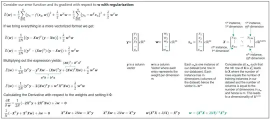

I can follow the derivation of the closed form solution for the regualarized linear regression like shown here up to a specific point: enter image description here
Where I get stuck is the part on the bottom of the slide:
$\mathbf{X}^{T}\mathbf{X}\mathbf{w}+\lambda N\mathbf{w}=\mathbf{X}^{T}\mathbf{y}$
$\mathbf{w}(\mathbf{X}^{T}\mathbf{X}+\lambda N\mathbf{I})=\mathbf{X}^{T}\mathbf{y}$
I understand that $\mathbf{X}^{T}\mathbf{X}$ is a $mxm$ matrix and $\lambda N$ is a scalar. So to add the two parts we must make the dimensions match. This is the point where I begin to struggle. I (rarely) understand that we can multiply $\lambda N$ with a $mxm$ identity ($\mathbf{I}$) to get the same dimensions as $\mathbf{X}^{T}\mathbf{X}$. At this point I miss some intuition why we can do this since: $\lambda N\mathbf{I}$ has the values $\lambda N$ on its diagonal and zeros everywhere else. If we add this to $\mathbf{X}^{T}\mathbf{X}$, the diagonal values of $\mathbf{X}^{T}\mathbf{X}$ are increased/decreased by $\lambda N$. But why do we add this value only to the diagonal elements and why not to all elements of $\mathbf{X}^{T}\mathbf{X}$. So you see I miss some intuition in the application of the identity. Can anybody please explain me why this is useful and give me some intuition.
