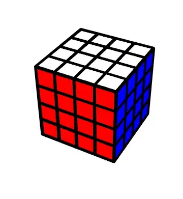

On a 4×4×4 or larger cube you can reach a configuration where the only visible difference from "solved" is that two of the stickers are out of place. (There will also be at least one center piece that has been replaced by another center of the same color, but that is not visible). See this animation for a sequence of moves exhibiting this. It permutes three center pieces in a 3-cycle, two of them on the same face so the visual net effect is one of two stickers trading places.

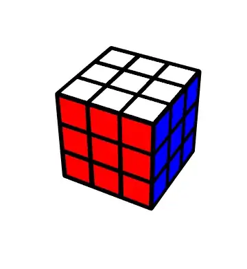

This is not possible on a 3×3×3 cube, because there are no identical center pieces to permute. The best you can do is three stickers out of place relative to solved, as @CooperCape points out in a comment. In the animation below the three cyclically permuted stickers are on the edge pieces of the top layer. The white faces of those cubes stay on the top surface, hence the appearance is that of three cyclically moved stickers. The cube in the animation has blue and green at opposite faces so the 3-cycle goes (green, blue, red).

So if your adversary decides which stickers you get to see, you might need to see all but $3, 2, 1, 1, 1, \ldots$ stickers before you know what the rest of the cube looks like.
