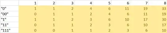

Use the inclusion-exclusion principle with the following 11 properties: 000 starting at position 1, 2, 3, 4, 5, or 6; 1111 starting at position 1, 2, 3, 4, or 5.
Edit: on second thought, inclusion-exclusion would be quite cumbersome here. A simpler approach is to consider the complement (as you are doing) and condition on the initial run (0, 00, 1, 11, or 111). Doing so yields the following table, with a column for each length. The value in each cell indicates the number of "bad" strings (do not contain 000 or 1111) of that length.
The length 1 column is trivial, and the rest of the values can be obtained recursively from columns to the left.
The sum of the last column is 109, which subtracted from $2^8$ yields 147.

  • I have not got. If there any mistake in my attempt? – Srestha Jul 14 '19 at 15:00
  • @Rob_Pratt. what ur column represents?? 1,2,3....,8 means?? – Srestha Jul 14 '19 at 16:23
  • The column 1,...,8 corresponds to the string length. For example, the row "0" column 3 entry is 2, which means there are 2 bit strings of length 3 that start with a run of "0" and do not contain 000 or 1111. Explicitly, they are 010 and 011, and the count is obtained recursively by summing 1+1+0 from the last three rows in column 2. – RobPratt Jul 14 '19 at 16:45
  • @Rob_Pratt , r u using any recurrence relation to calculate the whole table? – Srestha Jul 16 '19 at 14:19
  • $33$ is a huge number, right?? how u calculated number of string starting with "0" and not contain "000" or "1111" has 33 strings? – Srestha Jul 16 '19 at 14:27
    Yes, each value can be computed from values that appear in columns to the left. For, example, the 33 is computed as follows. If a string of length 8 starts with a run of exactly one 0, then the remaining positions 2 through 8 must come from a string of length 7 that starts with 1, 11, or 111. From column 7, there are 17+10+6=33 of these. – RobPratt Jul 16 '19 at 16:50
