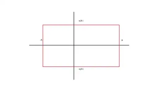

We prove the integral formula for $H$ using contour integration: Fix $t$. Observe that the function $$ f(x) = \frac{1 + (x+x^2)e^x}{xe^{xe^x} - t} $$ has exactly one pole on the real line, at the point $x=H(t)$. By noting that $\frac{d}{dx} xe^{xe^x} = (1+(x+x^2)e^x)e^{xe^x}$, we find that the residue at this pole is $\frac1{e^{{H(t)}e^{H(t)}}} = \frac{H(t)}t$. Hence for any counterclockwise oriented curve in $\mathbb{C}$ that surrounds $H(t)$ and includes no other solutions to $ze^{ze^z}=t$ in its interior, we have $$ \frac{1}{2\pi i}\oint_\gamma f(x)dx = \frac{H(t)}{t} $$ Take $\gamma$ to be a rectangular contour: contour of integration Note that the integral along the top minus the integral along the bottom is equal to $$ 2\int_{-A}^A \Im(-f(x+i\frac\pi4))dx $$ (negative because we are integrating right to left on the top of the box). Thus we need to show that the integral over the left and right sides of the box goes to 0, and that $f$ has no more poles inside the region. To see that $f$ goes to 0 on the left and right sides, observe that as $x$ goes to infinity, if $|\Im x|<\pi/2$, then the denominator goes to infinity doubly exponentially, making the whole fraction go to 0 rapidly. When $x$ goes to negative infinity, the denominator goes to infinity linearly, while the numerator is bounded. Since both the right and left legs of the contour have constant length, if $f$ goes to 0 on them as $A$ goes to infinity, these do not contribute to the integral in the limit.
