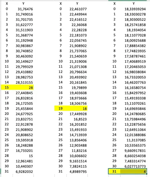

You can solve this easily using Excel. Clearly $0\leq x\leq \lfloor \sqrt{1009}\rfloor=31$ and $$ 1009=x^2+a y^2 \rightarrow y=\sqrt{1009-x^2\over a} $$ (here $a=1,2,3$). Just build a table of $y=\sqrt{1009-x^2\over a}$ for the 32 possible values of $x$ and check for integer $y$'s. You get the solutions $$ 1009= 28^2+15^2 = 19^2 + 2\times 18^2 = 31^2 + 3 \times 4^2. $$ enter image description here
Of course you can also easily program this if you know how to code.
