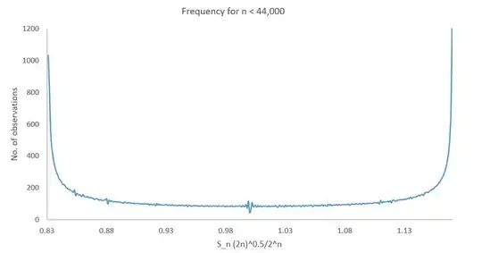

What is known about the distribution of the sum of the binomial coefficients over multiple of squares? My experimental data seems to suggest that for a given positive real $a > 0$ $$ s_{n,a} = \sum_{1\leq \lfloor ak^2 \rfloor\leq n}{n\choose \lfloor ak^2 \rfloor}= {n\choose \lfloor 1^2 a \rfloor} + {n\choose \lfloor 2^2 a \rfloor} + \cdots + {n\choose \lfloor r^2 a \rfloor} \approx \frac{2^n}{\sqrt{2an}} $$
Clearly the sum will be dominated by the term closest to the central binomial coefficient which in this case is the square nearest to $n/2$. What I found interesting is the shape of the histogram of the distribution of the ratios of the actual sum to its asymptotic estimate i.e. $\dfrac{s_n \sqrt{2an}}{2^n}$ are similar for all $a$ and look like an acr-sine distribution as mentioned in the comments.
Histogram of distribution for $a = 1$
Question 1: Why does it have an arc-sine like distribution?
Question 2 Where does the spikes occur? E.g. for $a = 1$, the spikes occur roughly at $1 \pm 1/6$.
Related question: What is the sum of the binomial coefficients $n \choose p$ over prime numbers?
  • As you say, it is probably about the distance between a square and $n/2$. Normalize it so $x=((n/2)-m^2)/m$ where $m^2$ is the largest square below $n/2$. Then $x is between 0 and 2. – Empy2 Jul 09 '19 at 10:56
    Let $t_n = s_n \sqrt{2n}/2^n$. If you plot $t_n$ against $\sqrt{n}$ you get approximately a sine wave with period $\sqrt{2}$, oscillating between roughly $5/6$ and $7/6$. That suggests that what you're observing is an arcsine distribution (https://en.wikipedia.org/wiki/Arcsine_distribution) on the interval $[1-\delta, 1+\delta]$ where $\delta \approx 1/6$. I have no idea how one would prove this though. – Michael Lugo Jul 09 '19 at 14:02
  • I finally got where the sum ends up (at the last square less than n), and that actual plot is an histogram (in n). Could have been made clearer in the post... – Olivier Jul 10 '19 at 08:59
    @MichaelLugo An arcsine distribution implies that the asymptotic value is the least likely value of $s_n$. In other words can we say that the true value of $s_n$ tends to be as far as possible from its asymptotic estimate ???? – Nilotpal Sinha Jul 14 '19 at 07:29
This is a part of ongoing research with Nilotpal Kanti Sinha. The answer does not explain fully why we have such distribution, but it will help understanding the distribution of the values of $\frac{s_n{\sqrt{2an}}}{2^n}$. I used $S_{n,a}$ notation to include its dependence on $a$.
Theorem 1
Let $\beta_n=\beta_{n,a}=\frac n2 - a(\lfloor \sqrt{\frac n{2a}}\rfloor)^2$. Then $$ \frac{S_{n,a}\sqrt{2an}}{2^n}=\frac{2\sqrt a}{\sqrt{\pi}} \sum_{k\in\mathbb{Z}} \exp\left\{-2\left(\frac{\beta_n}{\sqrt n}+k\sqrt{2a}\right)^2\right\}+O\left(\frac{\log^3 n}{\sqrt n}\right). $$
Corollary 1
Let $x_n=x_{n,a}=\beta_n/(\sqrt{2an})$. Then $$ \frac{S_{n,a}\sqrt{2an}}{2^n}=1+\sum_{k=1}^{\infty}2 e^{-\frac{\pi^2}{4a} k^2} \cos2\pi k x_n+O\left(\frac{\log^3 n}{\sqrt n}\right). $$
The first harmonic gives a good approximation of the magnitude of the oscillation $1\pm 2e^{-\frac{\pi^2}{4a}}$.
