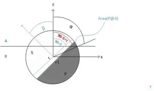

Now consider a different situation where P and S are not equally coated rather S>P. To show that I have introduced another angle γ also $r1$ the radius of the base of the cap. enter image description here
Now how can i write $z$ as an increased angle? what will be the limits of integration for a spherical cap? Is there any particular analytical solution exists to calculate the area P(grey) into A(air) as a function of $α,γ,β$?
