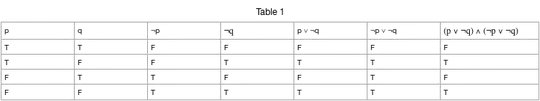

In my text book I'm asked to deduce a simpler expression for
(p ∨ ¬q) ∧ (¬p ∨ ¬q)
Looking at an equivalency table I did, it seems p ∨ ¬q gives the same results as (p ∨ ¬q) ∧ (¬p ∨ ¬q). However I'm not sure how you would deduce this without the table, as in, if I was outrightly asked to write the above in simpler terms I wouldn't know where to begin. Am I understanding this correctly?
My Table:
table

    You can use, for example, a ∧ (b ∨ c) is equivalent to (a ∧ b) ∨ (a ∧ c). Check your logic identities. That's the point of the exercise. – lurker Jun 15 '19 at 02:27
  • ah I see, so would that mean p ∧ (¬p ∨ ¬q) == (p ∨ ¬q) ∧ (¬p ∨ ¬q) – Ari Jun 15 '19 at 02:30
    I think something is buggy in your truth table $p \vee \neg q$ is true when $p$ is true – Kitter Catter Jun 15 '19 at 02:30
  • @AriVictor no. I don't see how you got that. Look carefully again at the identity. – lurker Jun 15 '19 at 02:34
  • @KitterCatter Sorry I don't follow? I understoof to mean when either is true, therefore if p is false and q is false, ¬ would be true making ∨¬ true? – Ari Jun 15 '19 at 02:35
    First row, $p$ is true, $\neg q$ is false so $p\vee \neg q$ should be true, you have it marked as false – Kitter Catter Jun 15 '19 at 02:37
  • @lurker right! I see, if we say a, b, c, then the three identities would be p, ¬p, and ¬q therefore ¬ ∧ (p ∨ ¬p) ? – Ari Jun 15 '19 at 02:38
  • @KitterCatter Ohh! I see now. – Ari Jun 15 '19 at 02:41
    No. p, ¬p, and ¬q are not identities. An identity is like what I showed you in my first comment. It's a logical rule showing how one form is equivalent to another. In your case the term (p ∨ ¬q) would correspond to a. – lurker Jun 15 '19 at 02:45
  • The column for $p$ or not $q$ is incorrect. You can see it because, in the table, it is the same as not $q$, which is suspicious since $p$ or not $q$ had more possibilities of truth, so it should be true more often than not $q$. – Taladris Jun 15 '19 at 07:23

Here's the corrected table:
$$\begin{array}{cc|cccc|c} P & Q & \neg P & \neg Q & P\lor\neg Q & \neg P\lor\neg Q & (P\lor \neg Q)\land(\neg P\lor \neg Q)\\\hline T&T&F&F&T&F&F\\ T&F&F&T&T&T&T\\ F&T&T&F&F&T&F\\ F&F&T&T&T&T&T \end{array}$$
From this, you can see that $(p \lor \neg q)\land(\neg p \lor \neg q) \iff (\neg q)$
