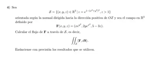

Here is the original question in Spanish.
exam question
    No disrespect but are you sure the question asks to find the flux itself and not the surface integral of the CURL of the vector field? The question seems to have been tailored so that the surface integral of the curl is easily calculated through applying stokes' theorem and it comes down to evaluating the integral of $\cos\left(\theta\right)\sin\left(\theta\right)e^{\sin^2\left(\theta\right)}$ along the unit circle ; which is exactly the type of question you'd expect in this exam. – Km356 Jun 12 '19 at 08:10
  • Yes, I am. I have added a picture of the question as it was asked in the exam, in Spanish. If I must be honest, part of me believes there must be something wrong with the question. Several PhD candidates have had a go at it, to no avail... and that's why I set a bounty! My main problem with using Stokes and carrying the thing to the border is that I know no viable integral to compute there. – Sam Skywalker Jun 12 '19 at 09:36
  • Also, thanks for editing it. – Sam Skywalker Jun 12 '19 at 10:41
  • I just would like to note two things based on experience: number one is that plugging values into $erf(x)$ is pretty easy, as long as your not plugging any values between -2 and 2 the answer is going to something that is very close to either positive one or negative one based on whether the input is positive or negative(check its graph), and number two is that trying a different/new change of variables might help find a solution in terms of more basic functions. – Malzahar Dec 22 '19 at 18:34
  • @Essam, thanks for your comment. However, I am far from familiar with error functions. In my attempt to solve the problem they appeared, but I couldn't go any further from that point and I supposed I was doing something wrong ($er\ f(x)$ did not appear in that course, targeted at second-years at uni). What change of variables would you suggest? – Sam Skywalker Dec 23 '19 at 21:35
