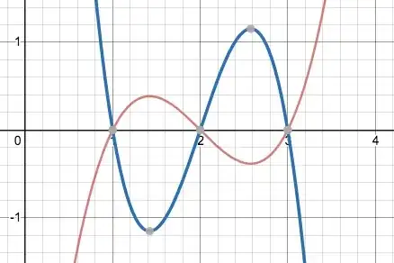

The accepted answer is deservedly so, a great explanation. As I read this, I thought of my students who are visual learners, for whom, a picture is worth a thousand words, and this would answer their question with almost no further comment.
The image above shows a simple $Y=(X-1)(X-2)(X-3)$ and an overlapping $Y=-3(X-1)(X-2)(X-3)$.
This helps show that manipulation made to an equation such as factoring may preserve the roots, but do not leave an equation with the the same nature, e.g. the end behaviour which might be important, is easily lost.
Edit - by popular demand, I'm adding the original graph, and an overlapping one with 2 as a double root.
    How about spicing it up with a polynomial for which (X-2) appears twice? Still the same roots, and it would show that we're talking about more than just trivial constant factors. – Andras Deak Jun 07 '19 at 15:38
