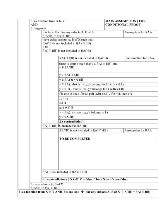

An incomplete proof of the --> part of the biconditional

In case your question in on the logical method : Different ways to prove an iff statement.
With : Proposition A = f is a one to one function
Proposition B = for all subsets ... the image of the intersection under f is the intersection of the images of the subsets.
(1) Prove A -> B
(2) Prove B -->A
(3) Conclude : A <--> B
(1) Prove A -> B
(2) Prove ~A --> ~B
(3) Use contraposition : on (2) : B --> A
(4) Conclude : A <--> B
(1) Suppose A is true and that B is false ( or the inverse: A false, B true) that is suppose : ~ (A <--> B)
(3) Derive a contradiction.
(3) Conclude that : (A <--> B)
