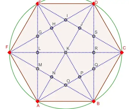

In the below diagram, A, B, C, D, E, F are beaver lodges and the segments in blue and red are burrows that connect the lodges. The dots marked with the letters G to S are crossing points where the beavers can change track. In the lodge A there are 3 beavers who want to reach their lodges in B, C and D. Obviously each beaver can follow several alternative paths to reach its lodge. According to the number of different paths that each beaver can follow, we will reward each with a corresponding number of apples. Each path consists of several burrows between the crossing points (the lodges in A to F can also be crossing points). A beaver can choose a specific burrow only if its ending crossing point is closer to its destination lodge, with respect to its point of origin. How many apples will each beaver gain?Lodges and burrows enter image description here

For example, from A to B I think it is AB, AOB, ANOB, AOPB, ANOPB.

    I think the problem is stated badly. English is my native language, and I'm not sure what "A beaver can choose a specific burrow only if its ending crossing point is closer to its destination lodge, with respect to its point of origin," means. I imagine "with respect to" is supposed to mean "than," but I can't swear to it. Also, does "choose a specific burrow" mean "change direction at a specific burrow?" If so, I don't think AOB is valid, because O is the same distance from A and B, so the beaver can't change direction there. (cont.) – saulspatz May 31 '19 at 12:28
  • Also, ANOB and ANOPB are invalid since N is closer to A than B. AOPB looks okay, as does AOPQB. This is all based on a shaky interpretation of the question though. Where does the question come from, by the way?
    – saulspatz May 31 '19 at 12:29
    @saulspatz apologies, English is not my native language! The point is the following: Each time we choose a segment (burrow), we compare the distance of its ending point (in our case, we start from A and want to reach B through O) from the destination point, with respect to the previous point. Haha sorry, it is confusing! In simpler words: We start from A. Then go to O. The distance OB is smaller from the distance AB; that is, we are closer to B. And we do this for every segment that is part of a path we choose. – Roberto Juan Carbajal May 31 '19 at 12:33
  • Same also for ANB: This path is valid, because N is closer to B, in respect to the previous point (A). – Roberto Juan Carbajal May 31 '19 at 12:34
    I apologize. I didn't realize this was your translation. I thought you were just repeating the question as it had been given to you. I didn't intend any criticism. – saulspatz May 31 '19 at 12:41
    I think perhaps what you want to say is, "He can only go to a burrow if it brings him closer to his goal." – saulspatz May 31 '19 at 12:46

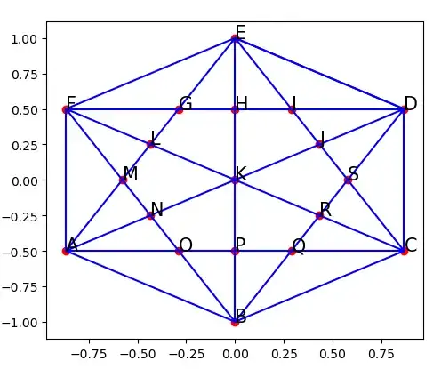

All in all, it is a graph traversal problem which you can solve with backtracking. I believe that he problem is NP complete, so you'll need an algorithm to count them all. I have implemented the graph and a depth-first search algorithm in python. It turns out that I was underestimating very much!

To test, here is a plot of the graph
for edge in edges:
  ls = nodes[edge[0]]
  le = nodes[edge[1]]
  plt.plot([ls[0], le[0]], [ls[1],le[1]], color="blue")
for p in nodes:
  l = nodes[p]
  plt.text(l[0],l[1],p)
  plt.scatter(l[0], l[1], color="red")
plotter graph
