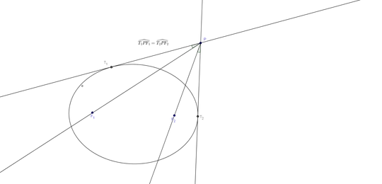

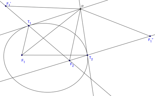

Let $F_1'$ be the image of $F_1$ under reflection in the tangent at $T_1$. Since the tangent at $T_1$ is the external bisector of $\angle F_1T_1F_2$, the points $F_2T_1F_1'$ are collinear. Likewise, let $F_1''$ be the image of $F_1$ under reflection in the tangent at $T_2$; then $F_2T_2F_1''$ are collinear.
Diagram
Now,
  1. $F_1'P = F_1P = F_1''P$ by reflection,
  2. $F_2F_1' = F_2T_1+T_1F_1 = F_2T_2+T_2F_1 = F_2F_1''$ by reflection and the defining property of an ellipse,
  3. $F_2P = F_2P$.
By SSS, $\triangle F_2PF_1' \cong \triangle F_2PF_1''$. In particular, $$ \angle F_2PF_1' = \angle F_2PF_1'' = \tfrac12\angle F_1'PF_1'' \tag{1} $$
Next, by construction, reflecting in the tangent at $T_1$ and then in the tangent at $T_2$ sends $F_1'$ to $F_1$ and then to $F_1''$. But the composition of reflections in two lines is a rotation around their point of intersection, by twice the (directed) angle between the lines. Thus $F_1''$ is the image of $F_1'$ under a rotation around $P$ by $2\angle T_1PT_2$; in particular, $$ \angle F_1'PF_1'' = 2\angle T_1PT_2 \tag{2} $$
Combining (1) and (2) yields $$ \angle T_1PT_2 = \angle F_1'PF_2 $$ Subtracting $\angle T_1PF_2$ from both sides yields $$ \angle F_2PT_2 = \angle F_1'PT_1 $$ Finally, by reflection, $\angle F_1'PT_1 = \angle F_1PT_1$, so $$ \angle F_2PT_2 = \angle F_1PT_1 $$ as desired.
Incidentally, from $\triangle F_2PF_1' \cong \triangle F_2PF_1''$ it also follows that, letting $Q$ be the intersection of $F_2T_1$ and $F_1T_2$, the triangle $F_1T_1Q$ and $F_2T_2Q$ have a common excircle, whose centre is $P$.

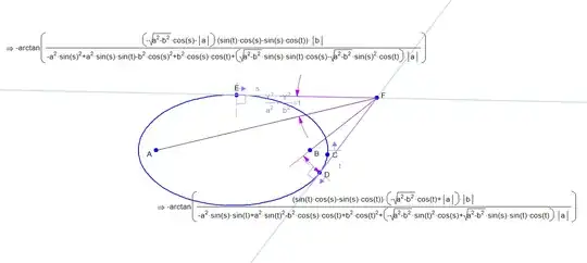

From Geometry Expressionsellipse angles
