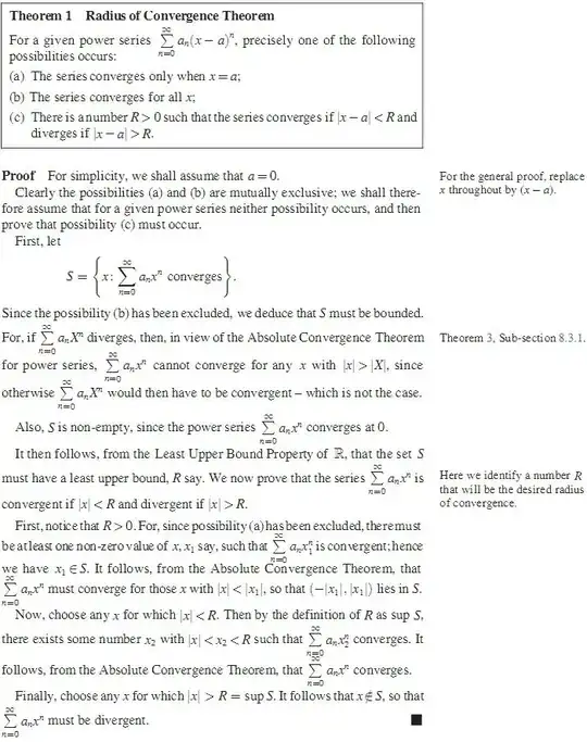

I can't figure out how it is valid to invoke the Absolute Convergence Theorem, whose hypothesis is "Let the power series have radius of convergence R", to establish case c of the Radius of Convergence Theorem (basically concluding that "the power series has a radius of convergence..."). Isn't it circular reasoning to prove X by assuming X itself?
(The aforementioned ACT is invoked beside the second, and subsequently again after the third, margin note below.) I would be extremely grateful for any help resolving this.
P.S. The above are excerpted from David Brannan's Mathematical Analysis.

It is a bit confusing the way he writes it, but what he actually shows in Theorem 3 (in the case $a=0$), is that if $\sum a_n x^n$ converges, then $\sum a_n y^n$ absolutely converges for any $|y|<|x|$. The invocation of $ACT$ is confusing since it speaks about a notion (radius of convergence) whose existence is proved in Theorem 1. However, in the proof of Theorem 3, $R$ is used only to take an $|x|<R$, so that we know $\sum a_n x^n$ converges. What he should have said is "from the proof of Theorem 3, etc...".
More details:
In the proof of Theorem 3 (in the book) he picks an arbitrary $|x|<R$ for which he has to show absolute convergence. Then he says there exists $X$ such that $|x|<|X|<R$. For this $X$ you have convergence, and from this convergence alone (no $R$ needed after this point) he deduces absolute convergence for $x$. Notice that at no point he assumes or uses that the series converges for $x$. He only uses radius of convergence to say that the series converges for $X$. In other words he proves the following: If $\sum a_n x^n$ is convergent, than for any $|y|<|x|$, $\sum a_n y^n$ is absolutely convergent.
For Theorem 1, IF a) and b) do not hold, there must be an $X$ for which the series diverges. He concludes that for any $|x|>|X|$, the series still diverges. Indeed, if it converges for some $|x|>|X|$, it would absolute converge for ANY $|y|<|x|$ (by the previous argument), in particular for $X$. Contradiction.
Theo
  • 2,335
  • @Ryan I edited the answer, perhaps now it is more clear and addresses your question. – Theo Mar 06 '13 at 16:56
  • Hey, thanks. I understand your explanation, but where did you get the proof of Theorem 3 from? I've just re-read it carefully, and what you say doesn't seem to be true; in particular, Thm 3 (and its proof) does seem to depend on the condition that a radius of convergence R exists, ie. that the series converges for all x such that |x|<R. If so, then my trouble with the argument of this current proof stands. – ryang Mar 06 '13 at 17:57
  • @Ryan Please see further edits. – Theo Mar 07 '13 at 01:03
  • Hey. Just before the boldface, you wrote, "For this X you have convergence." This is exactly where I infer that the theorem depends on the existence of a radius of convergence (R). This is why we know that "For this X you have convergence", as the bit just quoted is neither an assumption nor a hypothesis/condition. – ryang Mar 08 '13 at 09:59
  • @Ryan Yes, in the proof of Theorem 3 you have that from the existence of R. However, in the proof of Theorem 1, you have that the series converges for $x$ from the assumption by contradiction. IF (by contradiction)the series would converge for some $|x|>|X|$, it would also converge for all $|y|<|x|$, from the proof of T3. This $x$ is actually the capital $X$ in the proof of T3. – Theo Mar 12 '13 at 22:46
  • Oh I understand what you're saying, but my issue with the proof is that by using the argument in Thm 3 (as opposed to its result), the author is still assuming the shape/nature of the area of convergence (an interval about a centre, i.e. it's impossible for the series to be convergent for x=1 and x=3 but not x=2)--another thing that this theorem should be showing. So I still think that it's circular reasoning. Thanks so much for your input, it helped to sort out my thinking. – ryang Mar 22 '13 at 09:17
