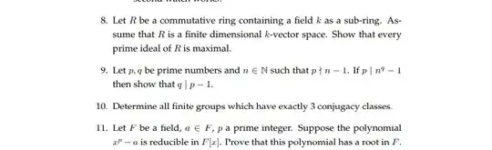

I need help with this question number 8, at least some hints or approaches to start with. Sorry for posting an image, I am only doing so , because I don't have a pc to type the question in latex and I don't know how to do so using mobile in any other way. the question

Hint:
Consider a prime ideal $\mathfrak p$ of $R$. Observe that $R/\mathfrak p$ is a finite-dimensional $k$-vector space. It is a consequence of the following result, which you can prove:
Let $A\subset B$ be integral domains such that $B$ is a finitely generated $A$-module. Then $A$ is a field if and only if $B$ is a field.
Edit: You can adapt the proof of the left-to-right implication to your context. Here's how:
All you have to show is that any non-zero element $\bar r\in R/\mathfrak p$ has a reciprocal. So consider multiplication by $\bar r$ in the quotient. Observe it is $k$-linear and injective. Furthermore $R/\mathfrak p$ is finite dimensional. What can you conclude from these elements?
Bernard
  • 175,478
  • I haven't studied modules since it was not in my bachelor's syllabus. Is there any other way that involve only ring theory and different integral domain chapters, including field extensions or linear algebra ,without the use of modules ? For example, can I somehow show this is an Principal ideal Domain since every prime ideal is maximal in it ? – raven chaser Apr 30 '19 at 21:40
  • Unfortunately, tere are plenty of examples where it isn't a P.I.D. You only need $\rightarrow$ for your question. I'll add some more details in a moment. – Bernard Apr 30 '19 at 21:44
If $D$ is an integral domain which is finite dimensional over some subfield
$k \subset D, \tag 1$
that is,
$\dim_k D = n < \infty, \tag 2$
then $D$ is in fact a field. For given
$0 \ne u \in D, \tag 3$
the set of the first $n$ powers of $u$
$S = \{1_D, u, u^2, \ldots, u^n \} = \{ u^k, \; 0 \le k \le n, \; k \in \Bbb Z \} \subset D, \tag 4$
must contain a linearly dependent subset by virtue of (2); thus there exist
$\alpha_i \in k, \; 0 \le i \le n, \tag 5$
not all $0$, such that
$\displaystyle \sum_0^n \alpha_i u^i = 0; \tag 6$
thus we have
$p(x) = \displaystyle \sum_0^n \alpha_i x^i \in k[x] \tag 7$
with
$p(u) = 0; \tag 8$
now granted that such polynomials exist, we may choose
$m(x) = \displaystyle \sum_0^{\deg m} m_i x^i \in k[x], \; m(u) = 0, \tag 9$
of minimal degree amongst all such $p(x)$; for such $m(x)$,
$m_0 \ne 0 \tag{10}$
lest we write
$m(x) = x \displaystyle \sum_1^{\deg m} m_i x^{i - 1}, \tag{11}$
and hence
$u \displaystyle \sum_1^{\deg m} m_i u^{i - 1} = m(u) = 0, \tag{12}$
which since $u \ne 0$ implies
$\displaystyle \sum_1^{\deg m} m_i u^{i - 1} = 0, \tag{13}$
i.e., $u$ is a zero of
$g(x) = \displaystyle \sum_1^{\deg m} m_i x^{i - 1} \in k[x], \tag{14}$
which contradicts the mininality of the degree of $m(x)$ amongst polynomials satisfied by $u$; thus
$m_0 \ne 0, \tag{15}$
and we have
$\displaystyle \sum_0^{\deg m} m_i u^i = 0, \tag{16}$
or
$u\displaystyle \sum_1^{\deg m} m_i u^{i - 1} = \sum_1^{\deg m} m_i u^i = -m_0, \tag{17}$
whence
$u \left (-m_0^{-1} \displaystyle \sum_1^{\deg m} m_i u^{i - 1} \right ) = 1, \tag{18}$
that is,
$u^{-1} = -m_0^{-1} \displaystyle \sum_1^{\deg m} m_i u^{i - 1}; \tag{19}$
since every $0 \ne u \in D$ is invertible, we conclude that $D$ is a field; indeed, a field extension of $k$.
We apply this result to the present situation as follows: if $P$ is prime in $D$, then $D/P$ is an integral domain, and (2) implies
$\dim_k D/P < \infty, \tag{20}$
as well; thus by what we have done above, $D/P$ is a field and hence $P$ is maximal in $D$. $OE\Delta$.
