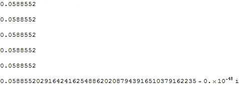

{a, b, c, d} = RandomReal[{0, 3}, 4, WorkingPrecision -> 50];
NIntegrate[
 Exp[-a/2 x^2 - b/2 y^2 - c/2 z^2 - d/2 w^2], {x, 0, Infinity}, {y, 0,
   x}, {z, 0, y}, {w, 0, z}]
NIntegrate[
 Sin[th]/Sqrt[a b d (b + c Sin[th]^2)] ArcTan[
   Sin[th] Sqrt[d/(b + c Sin[th]^2)]], {th, 0, ArcTan[Sqrt[b/a]]}]
  1/Sqrt[a ] NIntegrate[
  u ArcTan[u] 1/((d - c u^2) Sqrt[d - (c + b) u^2]), {u, 0, Sqrt[
   d/ (a + b + c)]}]
 Sqrt[d]/(Sqrt[a ] (b + c))
  NIntegrate[
  Sin[phi] ArcTan[
    Sqrt[d/(c + b)] Sin[phi]] 1/(d - c (d/(c + b) Sin[phi]^2)) , {phi,
    0, ArcSin[ Sqrt[( c + b)/ (a + b + c)]]}]
- I 2/(Sqrt[a ] Sqrt[d])
  NIntegrate[
   t /(c (-1 + t^2)^2 + b (1 + t^2)^2) Log[(
    1 + t^2 + 2 I Sqrt[d/(b + c)] t)/(
    1 + t^2 - 2 I Sqrt[d/(b + c)] t)], {t, 0, Sqrt[(b + c)/(
   a + b + c)]/(1 + Sqrt[a/(a + b + c)])}]
  NIntegrate[
     b (1 + t^2)^2) Log[((1/
        2 (2 I Sqrt[d/(b + c)] - Sqrt[-4 - (4 d)/(b + c)]) +
       t) (1/2 (2 I Sqrt[d/(b + c)] + Sqrt[-4 - (4 d)/(b + c)]) +
       t))/((1/2 (-2 I Sqrt[d/(b + c)] - Sqrt[-4 - (4 d)/(b + c)]) +
       t) (1/2 (-2 I Sqrt[d/(b + c)] + Sqrt[-4 - (4 d)/(b + c)]) +
       t))], {t, 0, Sqrt[(b + c)/(a + b + c)]/(
 1/Sqrt[a b c d]  1/4 NIntegrate[
  Sum[(-1)^(Floor[(eta - 1)/2]) (-1)^
    Floor[(xi - 1)/2] Log[
     t + (-1)^Floor[(xi - 1)/2] I Sqrt[d/(b + c)] + (-1)^(xi - 1)
        I Sqrt[( b + c + d)/(b + c)]]/(
    t - (-1)^(1 + eta +
        Floor[(eta - 1)/2]) I Exp[(-1)^(Floor[(eta - 1)/2]) I ArcTan[
         Sqrt[c]/Sqrt[b]]]), {xi, 1, 4}, {eta, 1, 4}], {t, 0, Sqrt[(
   b + c)/(a + b + c)]/(1 + Sqrt[a/(a + b + c)])}]
 1/Sqrt[a b c d]  1/4 Sum[(-1)^(Floor[(eta - 1)/2]) (-1)^
   Floor[(xi - 1)/2] FF[0, Sqrt[(b + c)/(a + b + c)]/(
    1 + Sqrt[a/(
     a + b + c)]), (-1)^Floor[(xi - 1)/2] I Sqrt[d/(b + c)] + (-1)^(
      xi - 1) I Sqrt[( b + c + d)/(
      b + c)], -(-1)^(1 + eta +
        Sqrt[c]/Sqrt[b]]]], {xi, 1, 4}, {eta, 1, 4}]

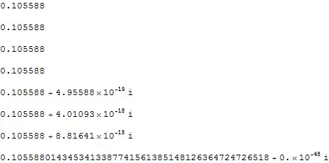

{a, b, c, d} = RandomReal[{0, 10}, 4, WorkingPrecision -> 50];
NIntegrate[
Sqrt[\[Pi]/2]/(Sqrt[c] Sqrt[d])
  NIntegrate[
  Exp[-a/2 x^2 - b/2 y^2 - 1/2 z^2] Erf[Sqrt[d/(2 c)] z], {x, 0,
   Infinity}, {y, 0, x}, {z, 0, Sqrt[c] y}]
 (2 \[Pi])/Sqrt[c d]
  NIntegrate[
  Exp[-a/2 x^2 - b/2 y^2] (ArcTan[Sqrt[d/c]]/(2 \[Pi]) -
     OwenT[Sqrt[c] y, Sqrt[d/c]]), {x, 0, Infinity}, {y, 0, x}]
(2  \[Pi]^2)/Sqrt[a b c d]
  NIntegrate[
  Exp[ -1/2 y^2]/Sqrt[2 Pi]
    Erfc[Sqrt[a/(2 b)] y] (ArcTan[Sqrt[d/c]]/(2 \[Pi]) -
     OwenT[Sqrt[c/b] y, Sqrt[d/c]]), {y, 0, Infinity}]
(2  \[Pi]^2)/Sqrt[
 a b c d] ((-\[Pi] ArcSin[Sqrt[b d]/
      Sqrt[(b + c) (c + d)]] + (\[Pi] - 2 ArcTan[Sqrt[a/b]]) ArcTan[
      Sqrt[d/c]])/(4 \[Pi]^2) +
   NIntegrate[
      Erf[Sqrt[a/(2 b)] y] OwenT[Sqrt[c/b] y, Sqrt[d/c]], {y, 0,
     Infinity}])
(2  \[Pi]^2)/Sqrt[
 a b c d] ((-ArcTan[Sqrt[b d]/ Sqrt[c (b + c + d)]] +
    ArcTan[Sqrt[d/c]])/(4 \[Pi]) +
   1/( 8 Pi^2)
     Sum[FF[1, Sqrt[(a + b + c)/(b + c)] - Sqrt[a/(b + c)],
       I  ((-1)^j Sqrt[d/(b + c)] + (-1)^Floor[1/2 (-1 + j)] Sqrt[(
           b + c + d)/(b + c)]), (-1)^(i + 1) Sqrt[c/(b + c)] +
        Sqrt[b/(b + c)] I (-1)^(1 + Ceiling[1/2 (-1 + i)])] (-1)^(
      j + Floor[(i - 1)/2]), {i, 1, 4}, {j, 1, 4}] )
