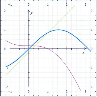

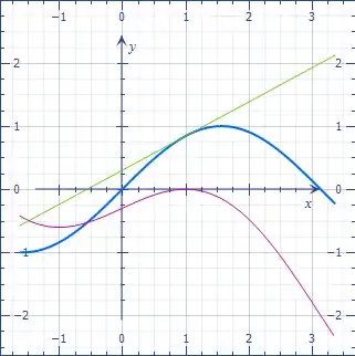

The idea is that the approximation gets better and better as $x$ gets closer to $a$, and, so to say, at $x=a$ it is no more approximative.
Below, a function in blue, the tangent in green and the difference in magenta. As you see, the difference decreases very quickly close to the tangency point.
This is not achieved with a different slope.
