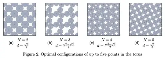

This is the latest result in this domain. Maybe it or its references or its subsequent citations (Google Scholar says it was cited by 16 later papers) could help:
Musin, Oleg R., and Anton V. Nikitenko. "Optimal packings of congruent circles on a square flat torus." Discrete & Computational Geometry 55, no. 1 (2016): 1-20. Earlie arXiv version PDF download.
          Fig.2
