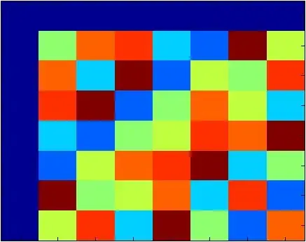

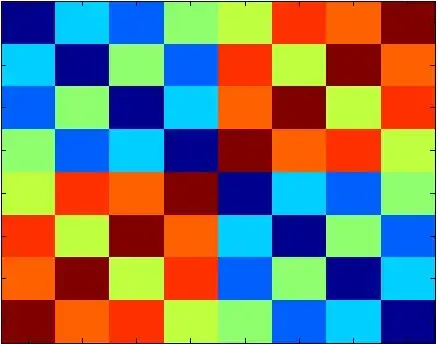

This is a form of graphical representation complementing the solution by @J. W. Tanner : here are (Fig. 1) the addition table and (Fig. 2) the multiplication table of this field.
Fig. 1 : Addition table. Please note the diagonal of zeros (deep blue) due to the fact that $w+w=0$, whatever $w$... remark as well the partition into blocks $4 \times 4$ : why that ?
Fig. 2 : Multiplication table. Please note the natural bordering by zeros......
How did I obtain them ? Without entering into the details, I will just say that instead of working with polynomials having their coefficients in $\{0,1\}$, I have been using a $3 \times 3$ matrix $M$ such that $M^3+M+1=0 \ \color{'red'}{modulo 2}$. It is easy to find such a matrix (the so-called companion matrix of polynomial $x^3+x+1$). Here it is :
$$M=\begin{pmatrix}0&1&1\\1&0&0\\0&1&0\end{pmatrix}$$
The elements of the field are thus all the $aI_3+bM+cM^2$, $a,b,c \in \{0,1\}$.
