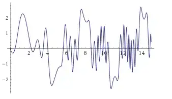

I am talking about finding a simple, exact, non-trivial solution such as $x = \pi/6$. Of course, $x=0$ or $x=\pi$ are trivial solutions. I created this equation with its exact solution in mind beforehand, so that's how I know the solution, but if you don't know the solution to begin with, how easy is it to find it, other than using trial and error? Is it an exam question that you could ask to high school students? Another similar equation is $\sin x + \sin(2x \sin x) = 1$ and it also has $x=\pi/6$ as a solution. Interestingly, Wolfram Alpha can not find the exact solution, only an approximation (with as many correct digits as you want). See plot of $\sin x + \sin(2x \sin x) - \sin 3x$, below.
