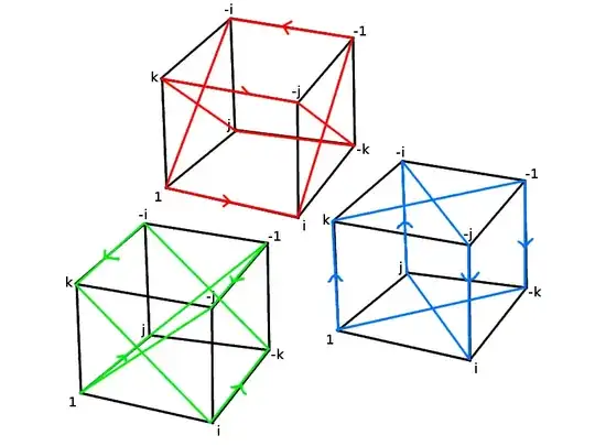

Applying Cayley's theorem we can represent $Q_8$ as a group of permutations on $8$ symbols:
$$\begin{array}{|ccc|} \hline 1 & i & j \\ \hline -1 & -i & -j \\ \hline i & -1 & -k \\ \hline j & k & -1 \\ \hline k & -j & i \\ \hline -i & 1 & k \\ \hline -j & -k & 1 \\ \hline -k & j & -i \\ \hline \end{array}$$
Then the group is generated by
$$i = (1\;i\;\bar 1\;\bar i)(j\;k\;\bar j\;\bar k)$$
and
$$j = (1\;j\;\bar 1\;\bar j)(i\; \bar k\;\bar i\;k),$$
for completeness
$$k = (1\;k\;\bar 1\;\bar k)(i\;j\;\bar i\;\bar j)$$
So here is a labelling of the vertices of a cube and the action of $\color{red}i,\color{green}j,\color{blue}k$ on it:
A problem is that we can't twist these without making vertices pass through each other.

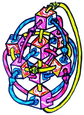

In 2014 (a year after this question was posted), Vi Hart and Harry Segerman released the very nice paper The quaternion group as a symmetry group, answering it. This paper presents a 4-dimensional object whose symmetries are precisely $Q_8$. Specifically, it’s a certain decoration on a hypercube; unfortunately it is somewhat intricate to describe, but good descriptions/illustrations can be found in that paper. Here is one as a taster:
Decoration scheme showing Q8 acting on the hypercube of monkeys
