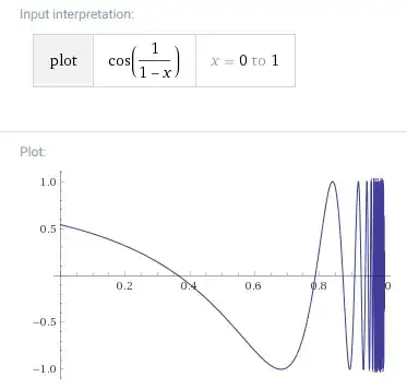

The first bullet is ruled out by the stipulation that $f$ be bounded, so moving on to the second bullet, we need to make sure $\displaystyle \lim_{x \to 1} f(x)$ does not exist. One way of doing this (the only way I believe) is to have $f$ oscillate infinitely rapidly with non-vanishing amplitude as $x \to 1$. It looks like this is what you were trying to exploit, and what José Carlos Santos did (+1) in his answer (see graph below): $\displaystyle f(x) = \cos \left(\frac{1}{1-x} \right)$.
Generalizing his epsilon-delta argument, you can see that this condition is not only necessary, but also sufficient.
$\qquad \qquad \qquad \qquad$ enter image description here

Take $f(x)=\cos\left(\frac1{1-x}\right)$. If it was uniformly continuous, then, for each $\varepsilon>0$, there would be some $\delta>0$ such that $\lvert x-y\rvert<\delta\implies\bigl\lvert f(x)-f(y)\bigr\rvert<\varepsilon$. But this is not true. Take $\varepsilon=1$. Since there are values of $x$ arbitrarily close to $1$ such that $f(x)=1$ and there are values of $x$ arbitrarily close to $1$ such that $f(x)=-1$, then, no matter how small $\delta$ is, you will always be able to find examples of numbers $x,y\in[0,1)$ such that $\lvert x-y\rvert<\delta$ and that $\bigl\lvert f(x)-f(y)\bigr\rvert=2>\varepsilon$
