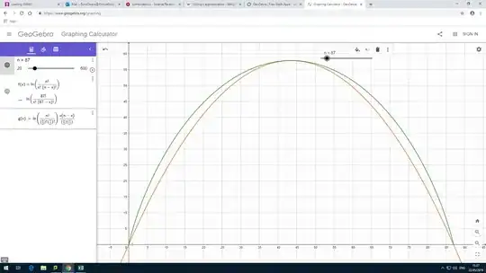

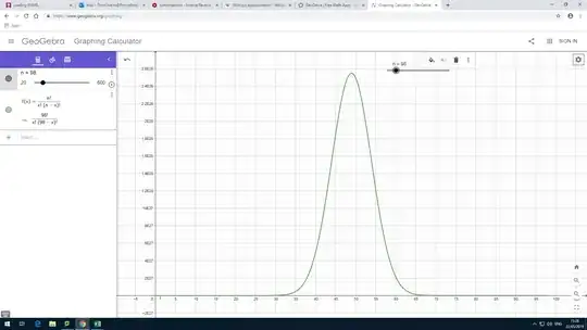

I started by considering the graph of $y=_nC_x$ - illustrated above.
I then looked at the natural logarithm - after all, Stirling's formula gives factorials as powers.

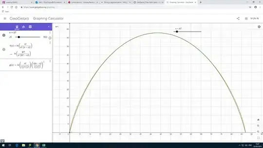

This curve looks like a quadratic, so I tried to fit a quadratic of the form $y=x(n-x)$.
You can see that this is not quite right. I therefore tried variations of the form $y=\left(x(n-x)\right)^p$ until I found a good fit with $p={3 \over 4}$
I don't know why this works, but it seems to. I'll now work on creating an inverse function, which should be quite easy.
We have the relationship $\ln(_nC_k) \approx ak^{3 \over 4}(n-k)^{3 \over 4}$
where $a=\frac{\ln\left(_nC_{n \over 2}\right)}{\left({n \over 2}\right)^{3 \over 4}\left({n \over 2}\right)^{3 \over 4}}$
$k^{3 \over 4}(n-k)^{3 \over 4}=\frac{\ln\left(_nC_k\right)}a $
$k(n-k)=\left(\frac{\ln\left(_nC_k\right)}a\right)^{4 \over 3} $
Let's call this $k(n-k)=b$, where $b=\left(\frac{\ln\left(_nC_k\right)}a\right)^{4 \over 3} $
Then $kn-k^2=b$ can be rewritten $k^2-kn+b=0$
$k_1=\frac{n-\sqrt{n^2-4b}}{2}$
$k_2=\frac{n+\sqrt{n^2-4b}}{2}$
I've tested this and the values it gives for $k$ are pretty close - probably only need to test integers one or two above and below the value of $k_1$.
I would really appreciate an explanation of why this works!

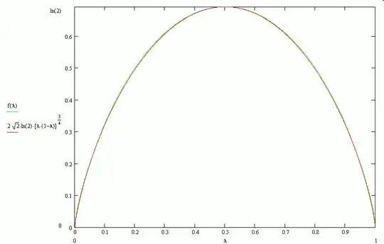

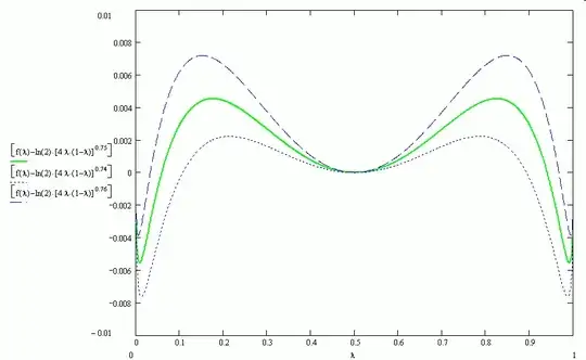

where $f(\lambda)=- \lambda \ln\lambda -(1-\lambda) \ln(1-\lambda) $.
The graphs below suggest that a function $g(\lambda)=2\sqrt{2}\ln (2)(\lambda(1-\lambda))^{3/4}$ is an extremely good approximation of $f(\lambda)$.
