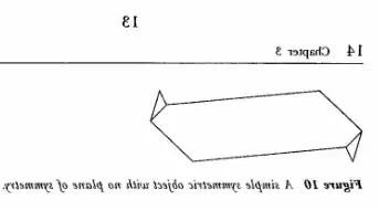

For one thing, the claim about Figure 10 is debatable: it does not "look the same in a mirror". I checked:
mirror image
Figure 10 is centrally symmetric, that is, it's invariant under point reflection. In the plane, point reflection is the same as rotation by 180 degrees. So one can also say that it has rotational symmetry (of order 2, because we rotate by $1/2$ of full turn).
Of course, it's up to the author which sets to call symmetric. Maybe he contemplated the central symmetry before deciding that in this book symmetric should mean "invariant under reflection in a line/plane". Or maybe the second highlighted sentence is really meant to emphasize the possibility of having several planes of symmetry, not to formalize the concept of symmetric. At least this is how I read it.
  • It looks the same as a flipped-over copy of itself in the mirror. I think that is what the author meant: It is not invariant under any nontrivial rotation, or any mirror reflection, but it is invariant under a mirror reflection followed by a rotation (i.e. it is point symmetric in 3D). –  Feb 26 '13 at 22:26
  • @ℝⁿ. After reading "such an object is said to have rotational symmetry" I concluded that the figure must be a planar object with 2-fold rotational symmetry. Now I see it was really 3-dimensional, with corners bent up/down. Well, this is not what I would call rotational symmetry. But it's the author's decision anyway. –  Feb 26 '13 at 22:39
