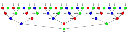

Suppose that $T=(V,E)$ is a 3-regular tree with root $0$. Suppose that $0$ is colored green. All other vertices are colored blue, red or green, such that each vertex has exactly one neighbour of each color. Multiple colorings are possible. Just pick one.
Let $R=(R(n))_{n \geq 0}$ be a random walk on $V$ that starts at the root, so $R(0)=0$. At each step, it steps to the (nearest) neighbour colored $x\in\{\text{blue},\text{red},\text{green}\}$ with probability $p_x$. Assume that $p_{\text{blue}},p_{\text{red}},p_{\text{green}}>0$ and $p_{\text{blue}}+p_{\text{red}}+p_{\text{green}}=1$. It is known that $R$ is transient. For each subtree induced by vertices L, M, R (see figure) I wish to compute the probability that $R$ "escapes to infinity" in that specific subtree. This problem is trivial if $p_{\text{blue}},p_{\text{red}},p_{\text{green}}=\frac{1}{3}$: for each subtree induced by L, M, R the walk $R$ escapes in it with probability $\frac{1}{3}$ by symmetry. I have tried to use similar symmetry arguments in the general case without succes. Can anyone help me with the general case?
