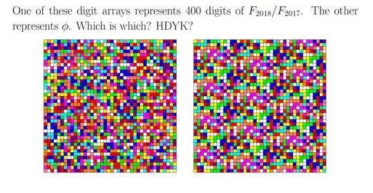

For this first question, I know how to apply the Euclidean algorithm and if I do, I get that the gcd is 1. I found this theorem online, thinking it might be able to piece together the relationship between the Euclidean algorithm and the Fibonacci numbers.
When it asks "What squares could you use to fill a 6765 x 4181 rectangle," I don't know what this means. What are the next steps in solving this problem? And is there any deeper relationship between the Fibonacci numbers and EA?
For the second question, I am assuming it is something similar as well. enter image description here

    what is the source of this? – Will Jagy Feb 20 '19 at 02:14
  • How do the colors map to actual values? – Haris Gušić Feb 20 '19 at 02:36
  • my teacher is the source. I don't know how the colors map to the actual values. I was just given these questions as part of my review sheet for my test. what really confuses me a lot is that i don't even know what fibonacci numbers are. our topic was graphing rational functions, and finding vertical asymptotes, holes, etc.. so i really don't know how any of this is related . – user8290579 Feb 20 '19 at 03:22
  • @user8290579 Fibonacci numbers are just numbers defined recursively as $F_n=F_{n-1}-F_{n-2}$, with $F_1=F_2=1$. – Haris Gušić Feb 20 '19 at 03:34
    Hint for the second question: $F_{2018}/ F_{2017}$ is rational, so the decimal expansion will be periodic. – Jair Taylor Feb 20 '19 at 04:02
  • what do you mean that the decimal expansion will be periodic? – user8290579 Feb 20 '19 at 16:23
  • @user8290579 It means that the decimal representation will contain chunks of numbers that repeat themselves. For example in $70/11=0.630630630...$, the sequence of digits "630" keeps repeating itself. Also, what is $\phi$ from the second part of the question? – Haris Gušić Feb 20 '19 at 21:43

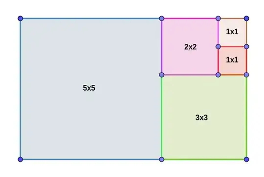

While I think that the question is poorly phrased, I think I know what they mean by "What squares could you use to fill up a 6765$\times$4181 rectangle". I will illustrate this on a scaled-down version of the problem.
We have that $F_6=8$ and $F_5=5$. Let's fill up a $8\times5$ rectangle with squares.
Fibonacci rectangle
One can see that we can fill up the rectangle perfectly with squares whose sides' lengths are all Fibonacci numbers up to $F_5$.
Why does this work for every pair of consecutive Fibonacci numbers?
Imagine that you are starting from one corner (e.g. the top right one as in the image) of the rectangle by placing a $1\times1$ square in it. Then, along the smaller side of the rectangle, place another $1\times1$ square. The two squares form another rectangle.
Now place another square ($2\times2$) next to the longer side of that rectangle. What results is yet another rectangle. Now just repeat the process until you use up all the Fibonacci numbers up to $F_6$.
Notice that by adding new squares, we will always get a new rectangle. What I mean by this is that the resulting figure will never be "jagged". This follows from the way that Fibonacci numbers are defined.
I think that this is what the question was going for, although it was not very well phrased, since there are many ways to fill up a rectangle with squares.
EDIT: The second part of the question
As Jair Taylor suggested in a comment, the number $F_{2018}/F_{2017}$ is rational and therefore its decimal representation will either have a finite number of digits or it will be periodic. This means that the decimal digits will contain repeating "chunks" of numbers. For example, in the decimal representation of the number $70/111$, the sequence "$630$" keeps repeating: $$70/111=0.\underbrace{630}\underbrace{630}\underbrace{630}...$$
Assuming that $\phi$ is the golden ratio, $\phi=\frac{1+\sqrt5}{2}$, its decimal representation will be unpredictable, because $\phi$ is an irrational number.
Looking at the pictures you provided, one can see that the first one is much more "chaotic" then the second one and one can hardly find any repeating patterns, whereas the second one obviously contains repeating patterns. This gives us good reason to conclude that the first image represents $\phi$ and the second one represents $F_{2018}/F_{2017}$.
  • wow, what a great explanation, thanks! so all the squares that can fill up are one of each of the fibonacci numbers from 1 to 20 right? what does the euclidean algorithm have to do with this problem? – user8290579 Feb 20 '19 at 03:25
  • @user8290579 Yes, but excluding $F_{20}$. The Euclidean algorithm's connection with this is that its intermediate results give you all the Fibonacci numbers in the reverse order. I will let you figure out why that is. – Haris Gušić Feb 20 '19 at 03:32
  • thank you so much, the explanation for the second question was really great and I understand it completely now. do you know of any more questions like these or where i can find some more to practice? – user8290579 Feb 21 '19 at 00:57
  • @user8290579 You are welcome! Unfortunately, off the top of my mind I don't know any good source of such problems. But if I manage to find some, I will let you know. – Haris Gušić Feb 21 '19 at 01:00
