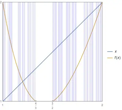

The following figure is a visualization of this phenomenon. It is the plot of both $y = x$ and $y = f(x)$ within the region $[1,2]\times[1,2]$, together with thin blue rectangles representing the set $f^{-7}([1,2])\times[1,2]$.
$\hspace{7em}$Iterations
