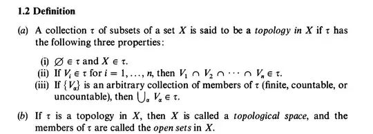

The following is the definition of an open set from Rudin's Real and Complex Analysis (3rd edition):
A closed set would be an open set's complement. From this definition, why would a closed set contain its limit points?
