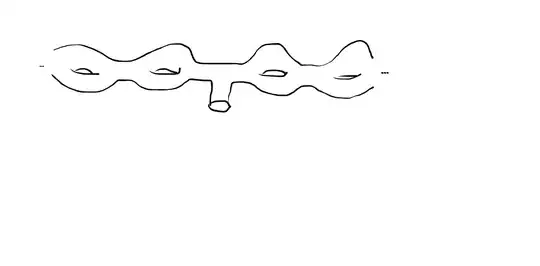

  3. A totally different example is to join two infinite-genus tori, and attach a cylinder to that: infinte genus tori with boundary
