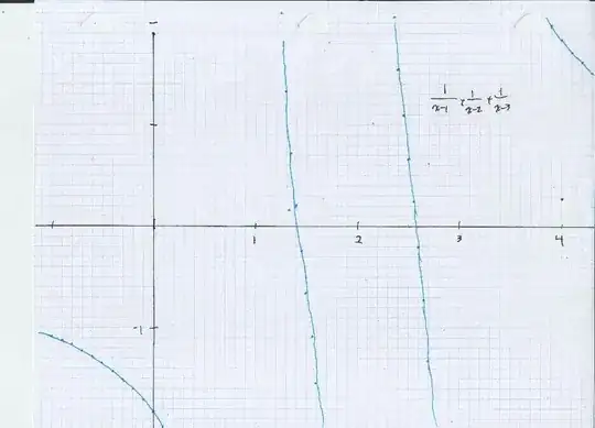

    @someone the way to figure this out with minimal theory is to draw a careful graph for, say, $\frac{1}{x-1} + \frac{1}{x-2},$ on graph paper by hand if you can, but in any case figuring out how to prove that what the picture indicates really does happen for any two real $a_1, a_2.$ Then the same thing for $\frac{1}{x-1} + \frac{1}{x-2}+ \frac{1}{x-3}.$ – Will Jagy Jan 16 '19 at 20:34

  • I drew a picture, posted. Scale is not the best for seeing the vertical asymptotes. – Will Jagy Jan 16 '19 at 21:08
  • That's it, thanks! –  Jan 16 '19 at 21:14
