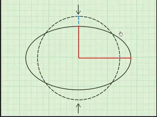

  1. An ellipse is a stretched circle. We get the formula for a unit circle, $x^2 + y^2 = 1$, and stretch it by dividing the terms like so: $\displaystyle \left(\frac{x}{a}\right)^2 + \left(\frac{y}{b}\right)^2 = 1$. In order to satisfy the same equation, for every $y$ we previously had, $x$ must get stretched by a factor of $a$, and for every $x$ we previously had, $y$ must be stretched (multiplied) by a factor of $b$.

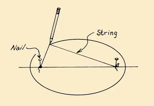

  1. An ellipse is the set of all points whose sum of the distances from two points, the foci, is a constant. We can represent this with the equation $\sqrt{(x+f)^2 + y^2} + \sqrt{(x-f)^2 + y^2} = c^2$, where $c = 2a$ from the previous equation, $f$ is the distance from a focus to the origin, and $x$ and $y$ are the variables.

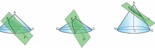

In this work we learn that conic sections were likely discovered by Menaechmus (380-320 BC). The priority of Menaechmus is justified here or in this Wikipedia article. Menaechmus sufficiently advanced the theory of the conic sections so that in antiquity these curves were called the Curves of Menaechmus. The cones were obtained by rotating a right triangle around one of its short sides, and a conic section obtained as section of conic surface by a plane orthogonal to the generating line. picture 10 The picture from the work quoted bellow shows a rightangle, obtusangle or acutangle conic, as they were called.

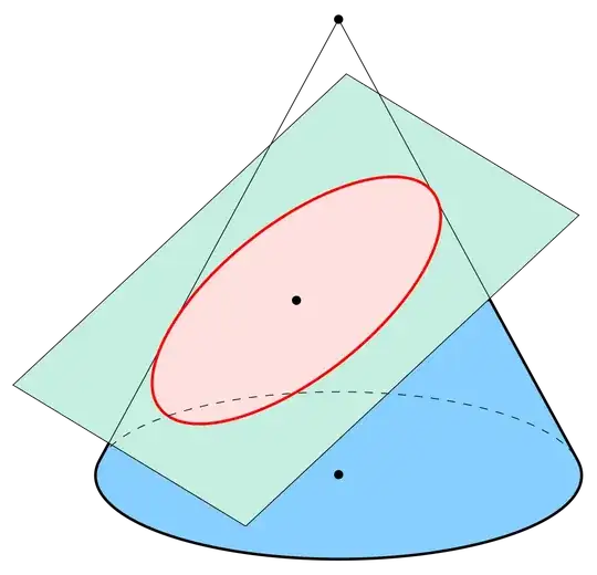

A nice proof that the focal definition of ellipse (sum of distances to two given points, foci, is constant), and ellipse as a section of a conic surface by a plane, is due to Germinal Dandelin (and Adolphe Quetelet) and is dated to 1822. The picture (bellow) is from wikipedia. wikipedia
