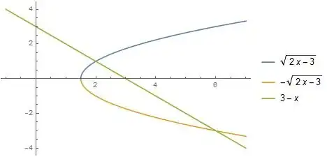

To build off of the other answers provided, the equation you wish to solve is
$$\sqrt{2x-3} = 3-x$$
To do so, you square both sides, and solve
$$2x-3 = (3-x)^2$$
which has two solutions. However this equation can also be obtained by squaring
$$-\sqrt{2x-3} = 3-x$$
The second solution is the solution to this second equation. This is easy to see with a plot:
