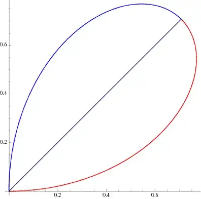

Next translate it above $y = x$ line symmetrically above x

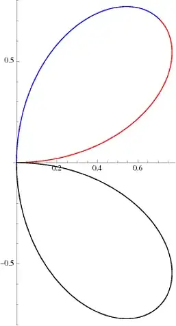

Then translate whatever you got to $x \geq 0,\ y \leq 0$ quadrant
below 0

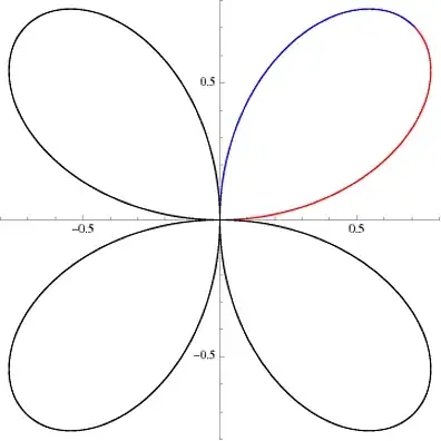

And finally translate it to $y \leq 0$ halfplane on left
I know, this only for $F = 0$ level set, but symmetry properties are valid for all level sets, only parametrization needs to be chosen differently.
