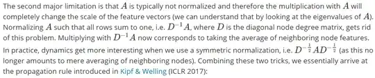

I'm trying to follow a blog post about Graph Convolutional Neural Networks. To set up some notation, the above blog post denotes a graph $\mathcal{G}$, it's adjacency matrix $A$, and the degree matrix $D$.
A section of that blog post then says:
Snippet from blog post
I understand how an adjacency matrix can be row-normalised with $A_{row} = D^{-1}A$, or column normalised with $A_{col} = AD^{-1}$.
My question: is there some intuitive interpretation of a symmetrically normalized adjacency matrix $A_{sym} = D^{-1/2}AD^{-1/2}$?
