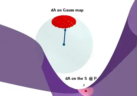

$$K(p) = \det \mathrm dN(p)=\frac{\mathrm dA(S^2)}{\mathrm dA(S)}=\frac{\det\left(\mathrm dN\circ \vec r\right)}{\det \vec r}=\frac{eg-f^2}{EG-F^2}$$
Or the Jacobian of the transformation between the two patches in the following diagram:

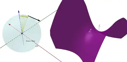

He writes $e,$ for example, as the image to a tangent vector $r_u$ on $S$ at point $p,$ i.e. $\mathrm dN_p(r_u)$ dotted with $r_u:$
$\bbox[5px,border:2px solid red]{ e =\mathrm dN_p(r_u)\cdot r_u = N \cdot r_{uu} }$
My question is why this last equality is true, including both the LHS and the RHS.
The other entries in the matrix being
$ f =\mathrm dN_p(r_u)\cdot r_v =\mathrm dN_p(r_v)\cdot r_u = N \cdot r_{uv}$
and
$g = \mathrm dN_p(r_v)\cdot r_u = N \cdot r_{vv} .$
I don't understand the application of the Gauss map to a tangent vector $r_u$ since the idea seems to be to apply it the normal vector to $S$ at the point $p.$ So applying it to a vector in the tangent space doesn't seem to make sense; yet it results in the dot product of the normal vector $N$ and the second derivative of $r$ with respect to $u.$
My bet is that $\mathrm dN$ may indicate the pushforward of the tangent space where $r_u$ is located. This wouldn't alter $r_u,$ given that the tangent space at $S^2$ is the same as at $S.$
