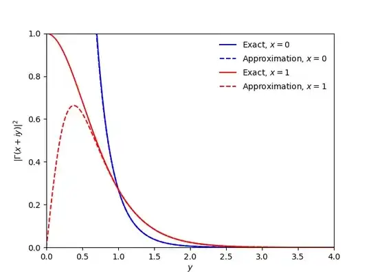

The plot below shows the accuracy of the approximation as function of $y$ for $x=0$ and $x=1$.

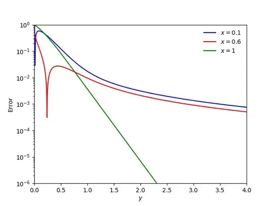

The plot below shows the error, defined as $\left| |\Gamma|^2_{exact}-|\Gamma|^2_{approx.} \right|/|\Gamma|^2_{exact}$. For $x=1/2$ the formula is exact; the error as function of $y$ seems to be identical for $x=0$ and $x=1$. The error here is plotted for $x=0.1$, $x=0.6$ and $x=1$.
For $x=1$, the error is lesser than $1\times 10^{-5}$ ($0.001 \%$) for $y>2$, agreeing with the original claim on the approximation. For smaller $x$ the error is larger. Suggestions regarding the estimation of the error analytically will be appreciated.

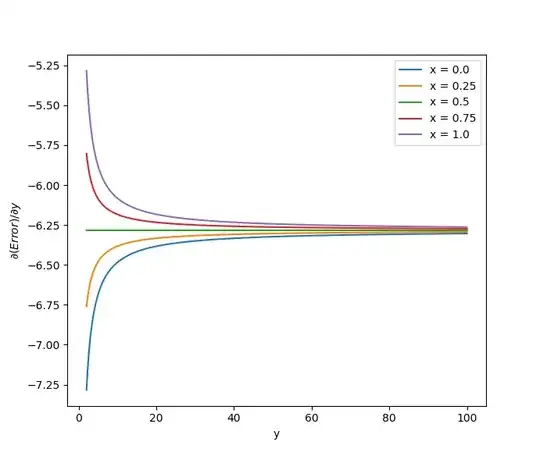

Second is to find the derivative of the error w.r.t $y$:
$$ \frac{\partial \delta}{\partial y} = sgn(\delta)\frac{\left[ (2x-1) \pi y^{2x-2} \left| \Gamma(z) \right|^{2} \cosh(\pi y) - \frac{\partial}{\partial y}\left( \pi y^{2x-1} \left| \Gamma(z) \right|^{2} \cosh(\pi y) \right)\right]}{\left| \Gamma(z) \right|^{4} \cosh^{2}(\pi y)} $$ $$ = \frac{\pi y^{2x-1}}{\left| \Gamma(z) \right|^{2} \cosh(\pi y )}\left[ \frac{2x-1}{y} -2\frac{\Re(-i \Gamma(z) \overline{\Gamma'(z)})}{\left| \Gamma(z) \right|} - \pi \tanh(\pi y) \right] $$ $$ = \frac{\pi y^{2x-1}}{\left| \Gamma(z) \right|^{2} \cosh(\pi y )}\left[ \frac{2x-1}{y} -2 \Im(\psi(z)) -\pi \tanh(\pi y) \right] $$
For this to be negative we need:
$$ \frac{2x-1}{y} \lt 2 \Im(\psi(z)) + \pi \tanh(\pi y) $$ $$ y \gt \frac{2x-1}{2 \Im(\psi(z)) + \pi \tanh(\pi y)} $$
which for $y \gt \gt 1$ approximates further to:
$$ y \gt \frac{2x-1}{2 \Im(\psi(z)) + \pi } $$
Of which $\Im(\psi(z))$ has the same sign as $y$ and so, for $y \gt \gt 1$ , the RHS is either small (compared to $y$) and positive for $0.5 \gt x \geq 1$, zero for $x=0.5$, or negative for $0 \geq x \gt 0.5$. Therefore:
$$ \frac{\partial \delta}{\partial y} \lt 0 $$
So, if we take $x = 0.7885$ and $y=2$ we get $\delta = 0.0042$ which could be taken as the upper bound of the error for which the approximations hold. Then as $y \rightarrow \infty$, $\delta \rightarrow 0$ and the approximation becomes more accurate.
