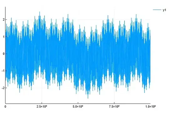

Writing \begin{align} &\quad \sum_{n=1}^N \left( n\sqrt{2} - \lfloor n\sqrt{2} \rfloor \right) \\ &=\int_1^N \left( n\sqrt{2} - \lfloor n\sqrt{2} \rfloor \right) {\rm d}n + {\cal O}(1) \tag{1} \\ &=\frac{1}{\sqrt{2}} \int_\sqrt{2}^{\sqrt{2}N} \left(x- \lfloor x \rfloor \right) {\rm d}x + {\cal O}(1) \\ &=\frac{1}{\sqrt{2}} \Bigg( N^2 - 1 - \Bigg[ \frac{\sqrt{2}N \left(\sqrt{2}N-1\right)}{2} + \frac{\left\{\sqrt{2}N\right\} \left(1-\left\{\sqrt{2}N\right\}\right)}{2} \\ &\quad - \frac{\sqrt{2} \left(\sqrt{2}-1\right)}{2} - \frac{\left\{\sqrt{2}\right\} \left(1-\left\{\sqrt{2}\right\}\right)}{2} \Bigg] \Bigg) + {\cal O}(1) \\ &=\frac{N}{2} + {\cal O}(1) \end{align} where we used $$ \int_0^x \lfloor t \rfloor \, {\rm d}t = \frac{x(x-1)}{2} + \frac{\left\{x\right\}\left(1-\left\{x\right\}\right)}{2} \, . $$ The order follows from the fact that $$ \frac{\left( \sqrt{2}N - \lfloor \sqrt{2}N \rfloor \right) + \left( \sqrt{2} - \lfloor \sqrt{2} \rfloor \right)}{2} = {\cal O}(1) \tag{2} $$ and $$\int_1^{N} \left( n\sqrt{2} - \lfloor n\sqrt{2} \rfloor \right)'' {\rm d}n \tag{3} \\ = \left( \sqrt{2}n - \lfloor \sqrt{2}n \rfloor \right)'\big|_{n=N} - \left( \sqrt{2}n - \lfloor \sqrt{2}n \rfloor \right)'\big|_{n=1} \\ =\sqrt{2} \sum_{k=-\infty}^{\infty}\left[ \delta\left( \sqrt{2} - k \right) - \delta\left( \sqrt{2}N - k \right) \right] $$ but this requires Euler-Maclaurin.
Due to the harsh critic about my somewhat heuristic argument I want to correct my approach as far as possible.
Set $$f(x)=x-\lfloor x \rfloor$$ and $$f_n(x)=\frac{1}{2} - \frac{1}{\pi} \sum_{k=1}^n \frac{\sin(2\pi k x)}{k} \, ,$$such that $$ \lim_{n\rightarrow \infty} f_n(x) = f(x) \, . $$ Since $f_n$ is differentiable we can use Euler-Maclaurin to calculate the sum $$ \sum_{k=1}^N f_n(ak) $$ with some $a$. The integral in (1) does not create much of an issue in the limit $n \rightarrow \infty$, since the limit is piecewise continuous and the integral can be splitted accordingly and then integrated. Also the limit of (2) is of ${\cal O}(1)$. So the problematic term which needs to be examined is the remainder $R_2$ ((3) was very heuristic) which can be written as $$ R_2=\int_1^N B_2\left(t-\lfloor t \rfloor\right) \frac{\rm d}{{\rm d}t} f_n'(at) \, {\rm d}t $$ neglecting unnecessary constants and $B_2$ is the second Bernoulli polynomial. We can express \begin{align} f_n'(at) &= 1-\sum_{k=-n}^{n} {\rm e}^{i2\pi k at} = 1 - \frac{\sin\left((2n+1)\pi at\right)}{\sin\left(\pi at\right)} \\ B_2\left(t-\lfloor t \rfloor\right) &= \left(t-\lfloor t \rfloor\right)(\left(t-\lfloor t \rfloor - 1\right) + \frac{1}{6} = \lim_{M \rightarrow \infty} \sum_{k=1}^M \frac{\cos(2\pi kt)}{\pi^2 k^2} \end{align} and integrate by parts $$ R_2=-B_2\left(t-\lfloor t \rfloor\right) \frac{\sin\left((2n+1)\pi at\right)}{\sin\left(\pi at\right)} \Bigg|_{1}^{N} - 2 \sum_{k=1}^{M} \int_1^N \frac{\sin(2\pi kt)}{\pi k} \frac{\sin\left((2n+1)\pi at\right)}{\sin\left(\pi at\right)} \, {\rm d}t \tag{4} \, . $$ For $a$ not an integer, the first term is bounded and ${\cal O}(1)$ as $n \rightarrow \infty$. The integral can be viewed as a functional for $n \rightarrow \infty$ in which case the Dirichlet kernel acts as a periodic delta-distribution $\sum_{m=-\infty}^{\infty} \delta(at-m)$ $$ \lim_{n \rightarrow \infty} \int_1^N \frac{\sin(2\pi kt)}{\pi k} \frac{\sin\left((2n+1)\pi at\right)}{\sin\left(\pi at\right)} \, {\rm d}t = \sum_{m=\lceil a \rceil}^{\lfloor Na \rfloor} \frac{\sin\left(\frac{2\pi km}{a}\right)}{\pi k a} \, . $$
Evaluating $$ \sum_{m=\lceil a \rceil}^{\lfloor Na \rfloor} \lim_{M\rightarrow\infty} -2\sum_{k=1}^{M} \frac{\sin\left(\frac{2\pi km}{a}\right)}{\pi k a} = \sum_{m=\lceil a \rceil}^{\lfloor Na \rfloor} \frac{2\{m/a\}-1}{a} \tag{5} $$
and using $\sum_{n=1}^{N}\{an\} = \frac{N}{2} + {\cal O}(?)$ this becomes ${\cal o}(N)$. So it is actually true ${\cal O}(1)$ does not follow.
We continue with the integral in (4) for $N$ integer \begin{align} &\quad -2\sum_{k=1}^\infty \int_1^N \frac{\sin(2\pi kt)}{\pi k} \frac{\sin\left((2n+1)\pi at\right)}{\sin\left(\pi at\right)} \, {\rm d}t \\ &=-4\sum_{m=1}^n \sum_{k=1}^\infty \int_1^N \frac{\sin(2\pi kt)\cos(2\pi m a t)}{\pi k} \, {\rm d}t \\ &=\frac{4}{\pi^2} \sum_{m=1}^n \sum_{k=1}^\infty \frac{\cos^2(N\pi m a)-\cos^2(\pi ma)}{k^2-m^2 a^2} \\ &=2\sum_{m=1}^n \left[ \frac{\cos^2(N\pi m a)-\cos^2(\pi ma)}{\pi^2 m^2 a^2} - \frac{\cot(\pi ma)\left(\cos^2(N\pi ma) - \cos^2(\pi ma)\right)}{\pi ma} \right] \end{align} where $a$ must be an irrational number now. The first term is ${\cal O}(1)$ for $n\rightarrow \infty$.
Any idea for the second?
It can be rewritten as \begin{align} &\quad \, \, \sum_{m=1}^n \frac{\cot(\pi ma)\left(\cos^2(N\pi m a) - \cos^2(\pi ma)\right)}{\pi ma} \\ &= \sum_{m=1}^n \frac{\cot(\pi ma)\left(\cos(N2\pi ma) - \cos(2\pi ma)\right)}{2\pi ma} \\ &= - \sum_{m=1}^{n}\cos(m\pi a) \, \frac{\sin\left((N+1)m\pi a\right)}{m\pi a} \, \frac{\sin\left((N-1)m\pi a\right)}{\sin(m\pi a)} \\ &= - \sum_{m=1}^{n} \frac{\sin\left((N+2)m\pi a\right)}{m\pi a} \, \frac{\sin\left((N-1)m\pi a\right)}{\sin(m\pi a)} + \sum_{m=1}^n \frac{ \sin\left(N2\pi ma\right) - \sin\left(2\pi ma\right) }{2\pi ma} \end{align} so the second sum is bounded again $\forall N$ and $n \rightarrow \infty$.
Not sure if it helps, but I have the following two identities for the sines $$ \frac{\sin\left((N-1)nx\right)}{\sin(nx)} = \sum_{l=2}^N \cos\left((N-l)nx\right) \cos^{l-2}(nx) $$ and $$ \frac{\sin\left((N-1)nx\right)}{\sin(nx)} = 1+2\sum_{l=1}^{\frac{N}{2}-1} \cos\left(l2nx\right) \, , $$ but evaluating this feels as if I'm running in circles.
I added a Figure of the RHS of (5) up to $N=10^6$ which doesn't look anything like $\log$, so either the numbers are just too small or I dont why it has to be $\log$.
