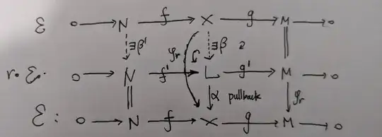

Now we consider the commutative case,we only need to check $r\cdot \varepsilon=\varepsilon\cdot r$,suppose $\varepsilon:0\rightarrow N\xrightarrow f X\xrightarrow g M\rightarrow 0$ is a short exact sequence in $R-Mod$. Then consider the following diagram: enter image description here The $\beta^\prime$ make all the diagram commute. $\beta^\prime$ is also the induced map between kernel, so it is unique. It is also induced by $\phi_r:X\rightarrow X$, hence $\beta^\prime=\phi_r:N\rightarrow N$. By the diagram we have:$r\cdot \varepsilon=\varepsilon\cdot r$.
