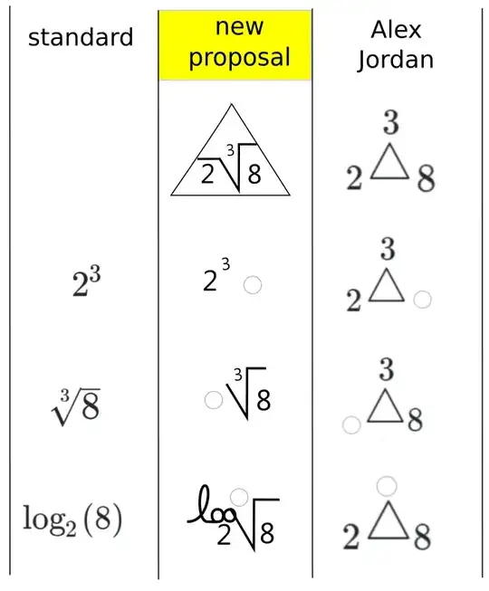

Always assuming $x>0$ and $z>0$, how about: $$\begin{align} x^y &={} \stackrel{y}{_x\triangle_{\phantom{z}}}&&\text{$x$ to the $y$}\\ \sqrt[y]{z} &={} \stackrel{y}{_\phantom{x}\triangle_{z}}&&\text{$y$th root of $z$}\\ \log_x(z)&={} \stackrel{}{_x\triangle_{z}}&&\text{log base $x$ of $z$}\\ \end{align}$$ The equation $x^y=z$ is sort of like the complete triangle $\stackrel{y}{_x\triangle_{z}}$. If one vertex of the triangle is left blank, the net value of the expression is the value needed to fill in that blank. This has the niceness of displaying the trinary relationship between the three values. Also, the left-to-right flow agrees with the English way of verbalizing these expressions. It does seem to make inverse identities awkward:
$\log_x(x^y)=y$ becomes $\stackrel{}{_x\triangle_{\stackrel{y}{_x\triangle_{\phantom{z}}}}}=y$. (Or you could just say $\stackrel{}{_x\stackrel{y}{\triangle}_{\stackrel{y}{_x\triangle_{\phantom{z}}}}}$.)
$x^{\log_x(z)}=z$ becomes $\stackrel{\stackrel{}{_x\triangle_{z}}}{_x\triangle_{\phantom{z}}}=z$. (Or you could just say $\stackrel{\stackrel{}{_x\triangle_{z}}}{_x\triangle_{z}}$.)
$\sqrt[y]{x^y}=x$ becomes $\stackrel{y}{\triangle}_{\stackrel{y}{_x\triangle_{\phantom{z}}}}=x$. (Or you could just say $\stackrel{}{_x\stackrel{y}{\triangle}_{\stackrel{y}{_x\triangle_{\phantom{z}}}}}$ again.)
$(\sqrt[y]{z})^y=z$ becomes $_{\stackrel{y}{_\phantom{x}\triangle_{z}}}\hspace{-.25pc}\stackrel{y}{\triangle}=z$. (Or you could just say $_{\stackrel{y}{_\phantom{x}\triangle_{z}}}\hspace{-.25pc}\stackrel{y}{\triangle}_z$.)
Having $3$ variables, I was sure that there must be $3!$ identities, but at first I could only come up with these four. Then I noticed the similarities in structure that these four have: in each case, the larger $\triangle$ uses one vertex (say vertex A) for a simple variable. A second vertex (say vertex B) has a smaller $\triangle$ with the same simple variable in its vertex A. The smaller $\triangle$ leaves vertex B empty and makes use of vertex C.
With this construct, two configurations remain that provide two more identities:
$_{\stackrel{y}{_\phantom{x}\triangle_{z}}}\hspace{-.25pc}\stackrel{}{\triangle_z}=y$ states that $\log_{\sqrt[y]{z}}(z)=y$.
$\stackrel{\stackrel{}{_x\triangle_{z}}}{_\phantom{x}\triangle_{z}}=x$ states that $\sqrt[\log_x(z)]{z}=x$.
I was questioning the usefulness of this notation until it actually helped me write those last two identities. Here are some other identities:
$$\begin{align} \stackrel{a}{_x\triangle_{\phantom{z}}}\cdot\stackrel{b}{_x\triangle_{\phantom{z}}}&={}\stackrel{a+b}{_x\triangle_{\phantom{z}}}& \frac{\stackrel{a}{_x\triangle_{\phantom{z}}}}{\stackrel{b}{_x\triangle_{\phantom{z}}}}&={}\stackrel{a-b}{_x\triangle_{\phantom{z}}}& _{\stackrel{a}{_x\triangle_{\phantom{z}}}}\hspace{-.25pc}\stackrel{b}{\triangle} &={}\stackrel{ab}{_x\triangle_{\phantom{z}}}\\ \stackrel{}{_x\triangle_{ab}}&={}\stackrel{}{_x\triangle_{a}}+\stackrel{}{_x\triangle_{b}}& \stackrel{}{_x\triangle_{a/b}}&={}\stackrel{}{_x\triangle_{a}}-\stackrel{}{_x\triangle_{b}}&\stackrel{}{_x\triangle}_{\stackrel{b}{_a\triangle_{\phantom{z}}}}&=b\cdot\stackrel{}{_x\triangle}_{a} \\ \stackrel{-a}{_x\triangle_{\phantom{z}}}&=\frac{1}{\stackrel{a}{_x\triangle_{\phantom{z}}}}& \stackrel{1/y}{_x\triangle_{\phantom{z}}}&=\stackrel{y}{_\phantom{x}\triangle_{x}}& \stackrel{}{_x\triangle_{1/a}}&=-\mathord{\stackrel{}{_x\triangle_{a}}}\\ \stackrel{}{_a\triangle_{b}}\cdot\stackrel{}{_b\triangle_{c}}&=\stackrel{}{_a\triangle_{c}}& \stackrel{}{_a\triangle_{c}}&=\frac{\stackrel{}{_b\triangle_{c}}}{\stackrel{}{_b\triangle_{a}}}& \stackrel{\stackrel{-n}{_y\triangle_{\phantom{z}}}}{_x\triangle_{\phantom{z}}}&=\stackrel{\stackrel{n}{_y\triangle_{\phantom{z}}}}{_\phantom{x}\triangle_{x}}& \end{align}$$

    Your idea got made into a YouTube video called the Triangle of Power – Mark May 04 '16 at 12:41
  • 38
    Excellent video names this notation Triangle of Power by the illustrious 3Blue1Brown. – Bob Stein May 04 '16 at 12:43

That’s my proposal for a "unified notation". Differs from Alex.Jordan's in two respects:
  1. "It needs to be a symbol with 3 'input' areas, that isn't symmetric under any rotation or reflection". Rationalist
  2. It’s closer to standard notation.
I love Day Late Don's vee-wedge notation. It's easy to remember $\wedge$ stands for exponentiation, while inverting it is the inverse operation. I'd like to go even further with that, and just use it as an operator symbol. If $a \times b$ is just $a$ added to itself $b$ times, and $a^{b}$ is just $a$ multiplied by itself $b$ times, why does exponentiation even deserve the fancy superscript notation? In fact, we can extrapolate (wrong term?) an infinite set of operators, creating each simply by saying it is equal to the last one applied to the same number ($a$) $b$ times, e.g. $a \times a$ repeated $b$ times is $a \wedge b$, $a \wedge a$ repeated $b$ times is $a$ 㫟 $b$, or whatever notation you want to use there, etc. Sorry if this doesn't answer anything for you.
